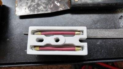

petronix likes 12VDC. Make sure you use a matching coil also. Most people jump the ballast resistor on the back.
Yes I know pertronix needs 12 volts, but bypassing the ballast on the regular method the coil will get also 12 volts, so shouldn't be used the stock coil... right ? thats is not specified ( as far I recall ) on pertronix ignitors systems instructions
MSD RTR distributors are on same deal! The internal module triggers the coil on - lead of coil just like stock, not feeding both leads on coils like external MSD modules
Bypass the ballast. Like Halifax said, most people jump the ballast with a piece of wire on the back, that way you can retain the stock look if that matters to you
THIS!!
there is a better and cleaner way to do it
remove resistor from groove on back and replace it with a jumper wire
