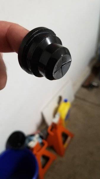

I use a 'baffled grommet' on my pcv...They're cheap enough so I bought an assortment of sizes in order to get one that fit and functioned best. Bought them from summit...it's basically a grommet that has a cylindrical body with tiny slits that let air flow to the pcv but keep oil from splashing onto the underside of the valve. Check 'em out

Uhhh....no. What the heck is that? Please tell me what it's all about. Is that for an evac system or something???? I would like to know.
Looks to me like it's just a raised PCV in twist style cap. The bottom is not perforated as a normal breather. Use it with the standard breather on the opposite cover. Not sure as I never tried one, but it may eliminate the need for an oil baffle in the valve cover and/or a second hole in one.
