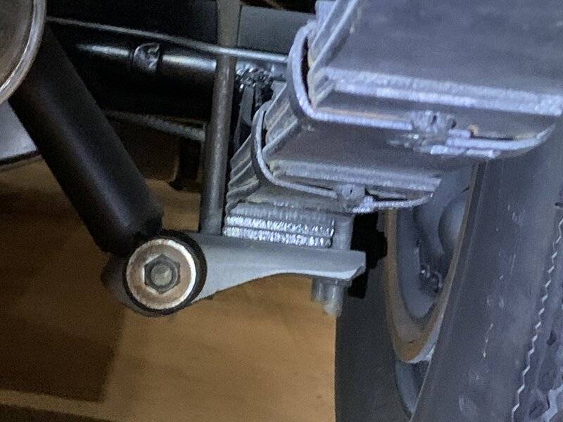

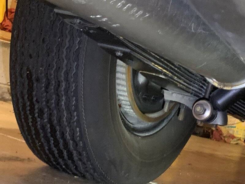

When the weather gets better this week I will share some pics of the GTX that I just purchased. In the meantime, I am going over a few things with this car. The most obvious thing that stood out to me was the fact that the passenger side is noticeably higher than the drivers side. Upon further inspection, I discovered that two spacers (or add-a-leafs) are installed on the passenger side. The driver side just has the springs mounted. The car was restored in the last five years and driven very little. Any idea why the springs would be set up that way? For reference, the car is a Hemi GTX. Would appreciate any thoughts before I start “fixing” things. Thanks.

Stick shift car with a dana? Those springs are stock (or stock HD replacements.) The trackpack/super track pack cars had biased extra leaves (or actually front half leaves) because of the physics that happens to a rear-end under acceleration. The superstock race springs are the same way. The passenger side is stiffer, because the physical reaction is to increase the load on the drivers side, and decrease on the passejger,passenger,, due to the direction the engine rotates.
Rear axles torque counter clockwise and biased leaf springs counter that..... they also help counter the clockwise torque of the engine.
440 cars have the same extra leafs too. If the car sits unlevel side to side I would look at the torsion bar adjustment first and get the front level. Probably the rear end will follow. Be sure to study the procedure in the service manual for removing/installing/adjusting TBs.
Edit: corrected crazy typos and IPad over-writing
A Hemi X would have either the Trac Pak or Super Trak Pak spring package. These are a biased design with the added front half leaves on the passenger side to counter the torque applied by the axle which is trying to force the passenger wheel up into the wheel well. The front half is stiffened to control the "wrap up"/ bending of front of the spring due to the force which is trying to rotate the pinion nose up during hard acceleration. This is a real good design.
Yup. Those are stock, not “add a leafs”.
And today I learned my first important point about a Hemi car. Didn't realize that this is actually the correct spring design for the car. Good to know that it isn't something I need to worry about.
