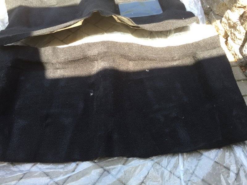

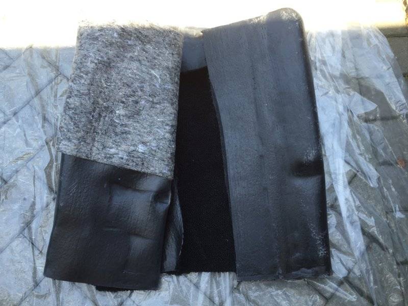

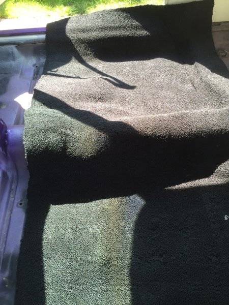

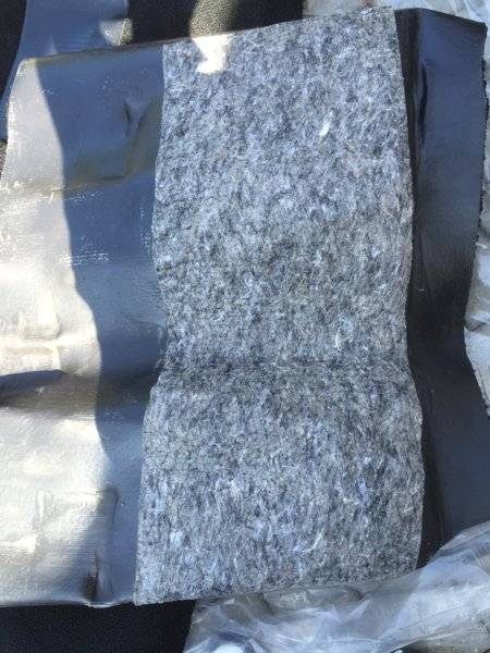

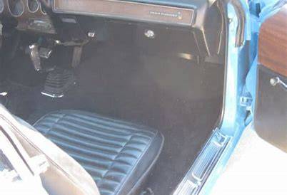

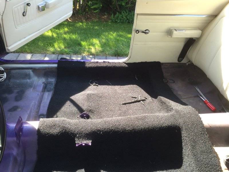

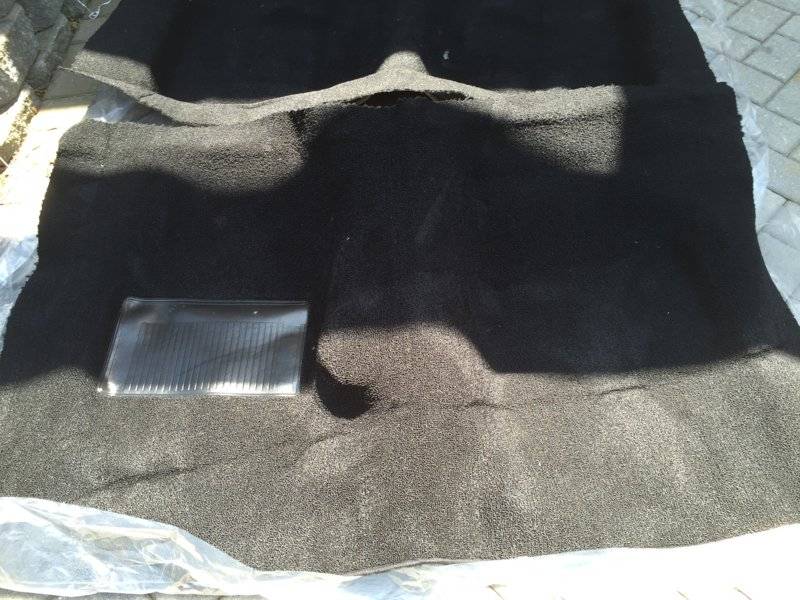

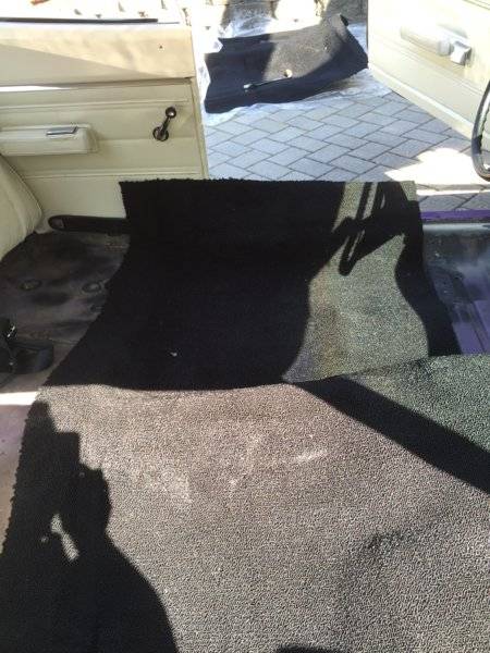

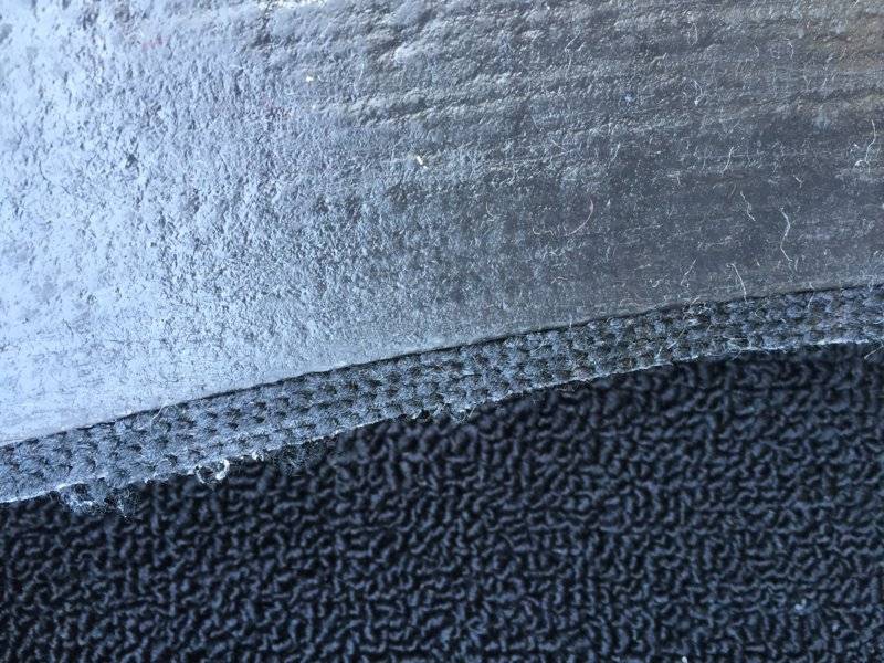

I used an ACC carpet with the heavy mass backing, basically rubber glued to the back of the carpet. As others have said, the carpet is formed to the floor pan. I laid mine out in the driveway for a few hours before install. It fit almost perfectly to the floor pan. Once trimmed and the seats/moldings put back in, the carpet didn't move at all and the fit was excellent. No glue used at all. Here's some pics.
