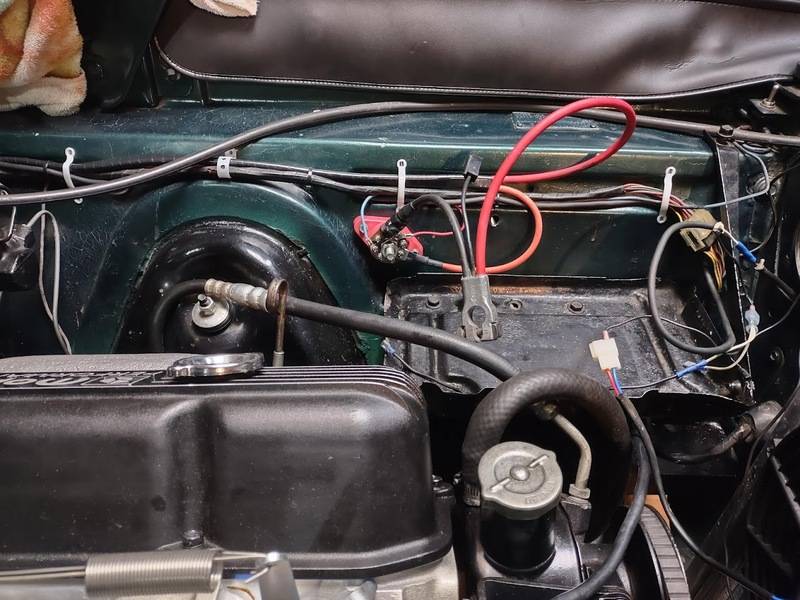

It's almost embarrasing but I'm an electrcial controls engineer and I never spent the time to fix my own revolving lights (they used to work 30 years ago).
Probably 20 years ago I wired the motors directly to a 3 position toggle switch.
I'm so used to it now it's just "the way the car is".
Someday I'll get back to it and probably work on controlling them individualy.
I kind of prefer working on performance and mechanical stuff at home.
