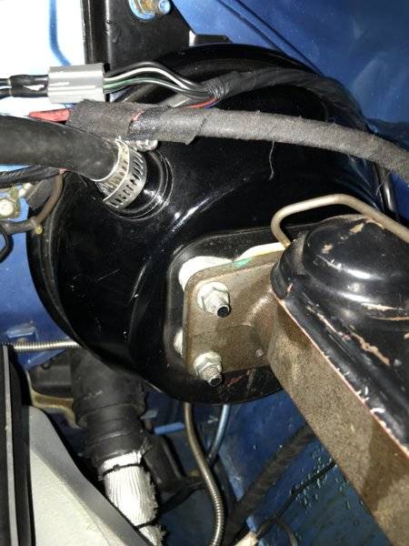

I have an original 70 GTX 440HP auto with PS/power drum brakes that I have been told does not have the original style booster, and after looking at online pics I would agree, mine appears newer and smaller and I don’t feel operates correctly when braking.
Anyone know what model I would need, or can that info be found on my fender tag or original build-sheet that I have?

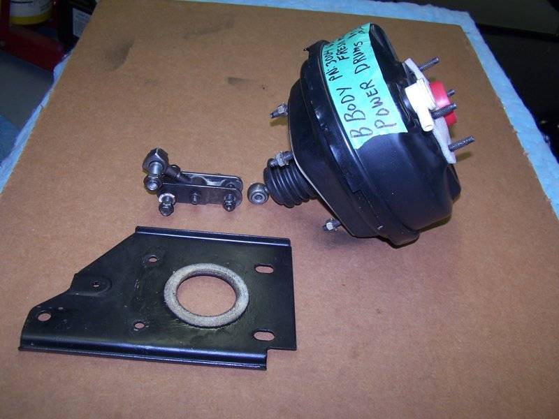

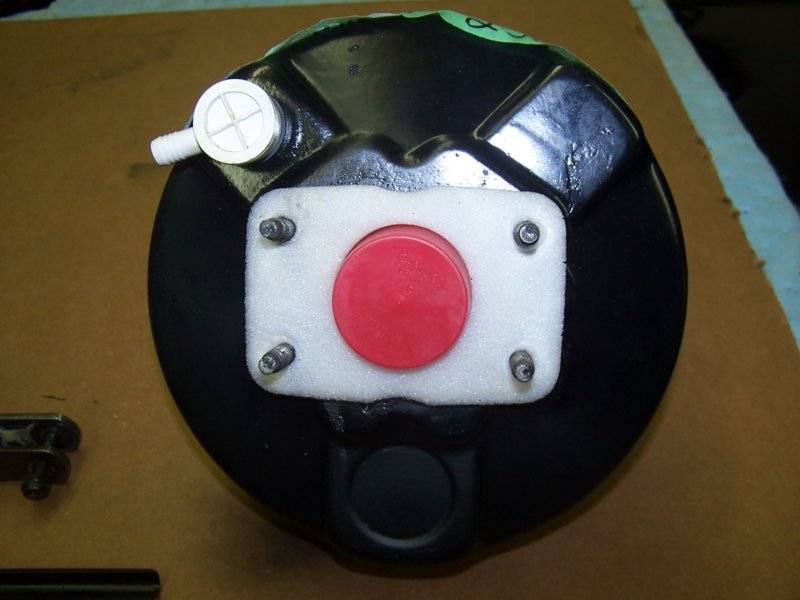

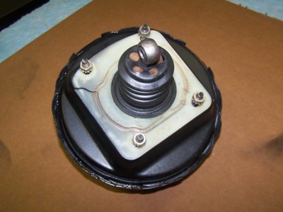

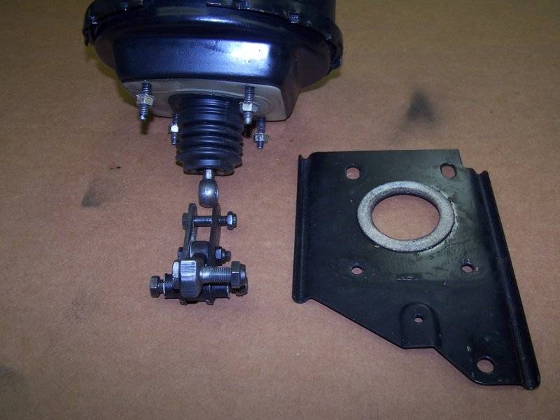

I have the booster that came on my 68 Charger with power drum brakes. I had it rebuilt by Booster Dewey and then upgraded to Power Disc brakes so needed the dual diaphragm booster. This is PN 3004608. I'm pretty sure it was used on the 70 models also. I have this complete set-up on FBBO for $250.00. If all you want is the Booster, I will sell it for $200.00. Here are some pics

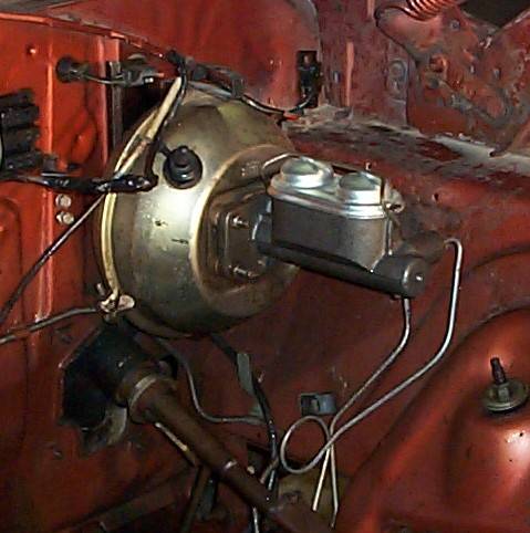

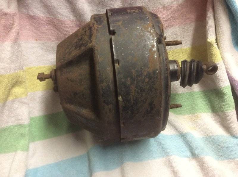

This is a picture of the same type of booster that is on my drum brake 66 Satellite. Don't for sure its right for a 70.

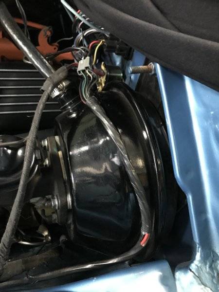

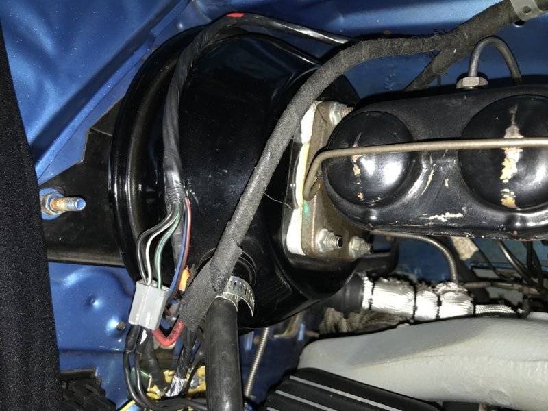

Here is the one out of my 23000 mile original 70 Charger 500. I always wondered if it's the original being so shiny and all. But at 23000 miles would have it needing replacement??

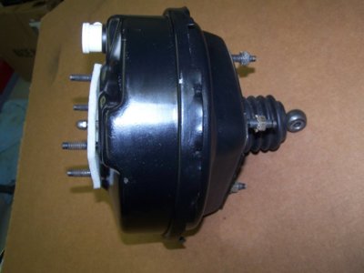

Here are a couple of mine

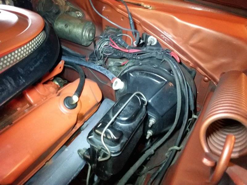

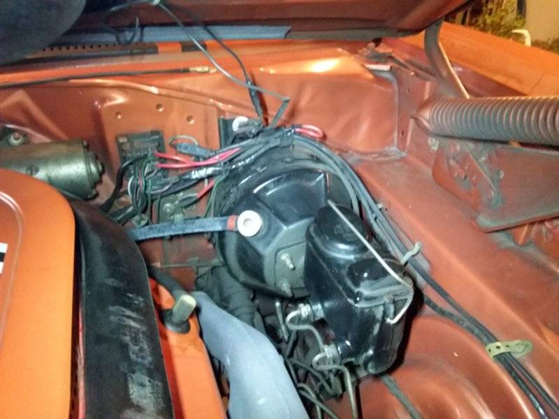

Do you have pics of the booster that is in your car now?

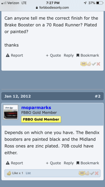

Hopefully someone can identify it. I'm not sure but it looks similar to the one in post #8 only painted black.
