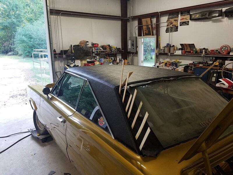

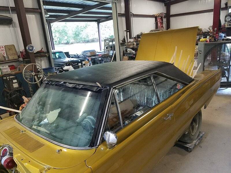

Before you do this I highly recommend that you get a widget the same size/width as the drip rail and figure out a way to clamp it.
When I did mine I thought I had a good plan, I was using wooden paint sticks doubling them up and just figured I would use sping clamps to hold it in there. It worked and the top is right but the clamps keep popping off and the sticks would lean.
I worked but I should have been better prepared. I also think afterwards I read that if putting a vinyl roof on that you are supposed to get rid of the dealer in the gutter. It may have been in the FSM, it's pretty detailed.

I used a lot of paint stick to tuck and hold around window gaskets, you will benefit from different size bondo spreaders.

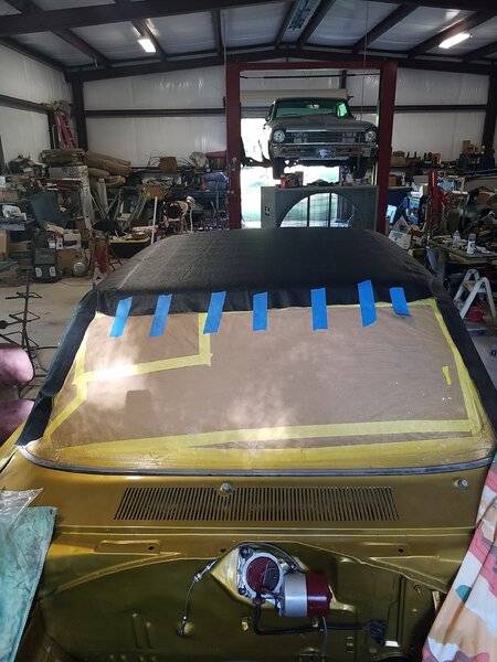

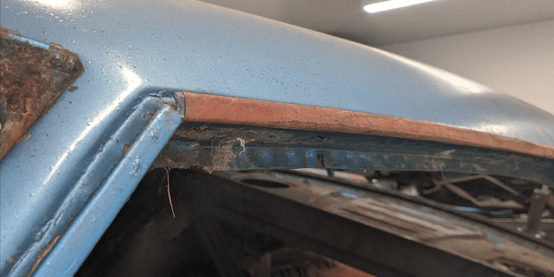

Mine turned out pretty good. Hardest spot was the b pillar, getting it tucked into the drip rail while wrapping around to the rear glass and the angle of the pillar made for some challenges.

Yep, I stand corrected here. I checked the FSM after I put my top on and it does state to wrap the vinyl over the top of the drip rail and trim it an 1/8" from the bottom, then apply sealer to the edges. That makes much more sense as far as keeping water from getting under the vinyl. I was worried about the trim not fitting since my car didn't originally have one.
My car is original vinyl. It wrapped completely over the rail and was cut just under the bottom I almost think the trim was all put on first and the vinyl cut directly to the trim on the underside but not totally sure.
