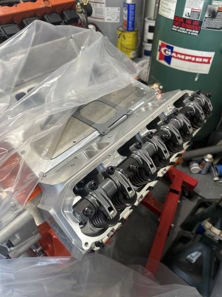

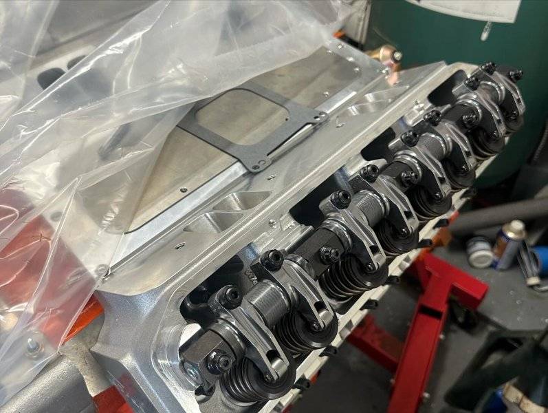

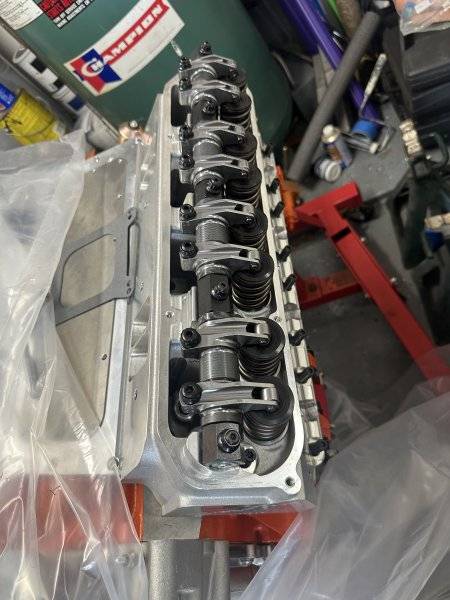

I don't think the Trick flow heads use a large offset intake rocker like the Victor MW (0.725") or INDY (0.800"), but you still might want to check both intake and exhaust pushrod lengths. On my Victor MW heads the Intake pushrods are 0.025" longer than the exhaust pushrods.
If cam duration is under 260@ 0.050" you should have good piston to valve clearance if using the ICON pistons.

I don't recall the pushrod lengths I used, just knew the rocker offset slightly affected them if I wanted to have about the same rocker adjuster lengths.
My T&D rockers use pushrods that are ball end on both sides. If your rockers use the cup end pushrod, make sure the adjustable checking pushrod has the cup.
That cam should have plenty of piston to valve clearance.

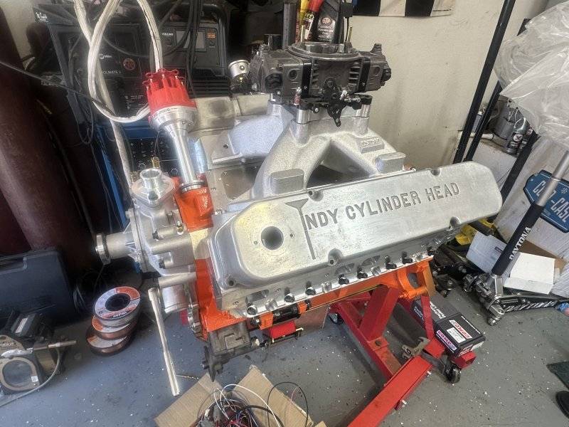

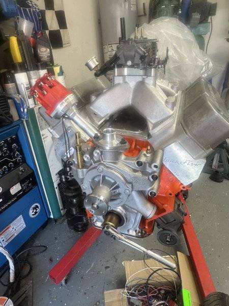

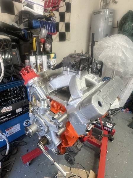

My 500" 400 stroker with the flat top ICON pistons has a 272/278 @ 0.050" 110 lsa solid roller (0.726" lift) it is installed at split overlap because piston to valve clearance was getting fairly close.
When I built the 505" 440 with the TF240 heads and a mild solid roller in the 240's @ 0.050" range there was plenty of PV clearance. and that has the 7.1" rods so more TDC piston dwell than the low deck 6.535" rods.
I have gathered the parts for another 512 RB440, but just bought the 4.25" low deck B stroker crank and 6.535" rods (no pistons yet.)
I thought it might be interesting to build them the exact same to see what difference rod ratio makes between a 512 RB and 512 B engine.
Just need a bunch more money :)
