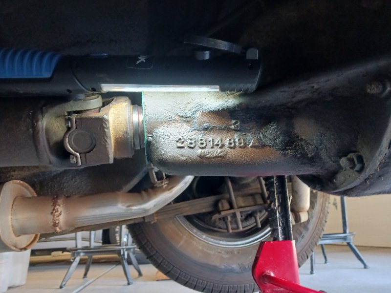

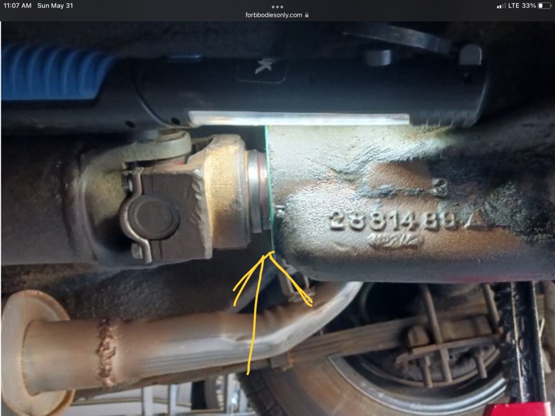

I tried doing the spin test because I wanted to determine the rear end gear ratio of my 68 Super Bee. What I believe I determined is that I have an open diff, but I was not able to determine the ratio because with both tires in the air and the auto trans in "N" per instructions, I could spin the tire several times before the driveshaft would move much at all. Nothing like the expected 2, 3, or 4 driveshaft rotations per one tire rotation. Am I doing something wrong in the test, or is something wrong with the car? The car runs and drives fine, but it will even not spin one tire off the line. Is it possible to have some slip in the diff? I am attaching one pic that shows a number on the 3rd member and when I look it up, Google says this is an 8 3/4 489 case. I am also attaching a pic of the build sheet showing numbers relating to pinion. Any help would be much appreciated!

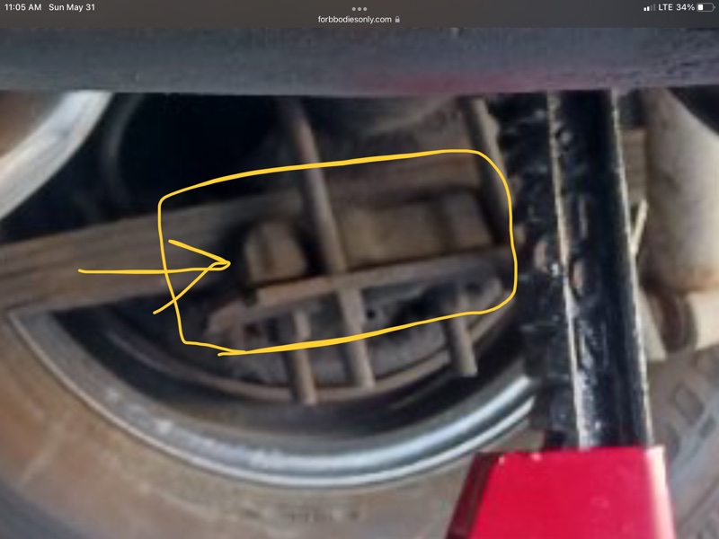

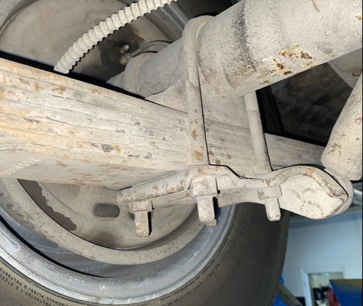

Why is the big block here at the leaf spring and axle connection. Photo one Should not be there. Stock set up shown in photo 2

The yoke should have a dust shield on it which is missing. It is still shiny and not rusted yet. 3rd photo
You can do it the other way. Turn your drive shaft and count the wheel revolution. Almost surprised that from the factory that it wouldn't have a sure grip. Looks like your leaf springs are sagging, not sure what that thick piece is between the the u bolt and spring. Someone has had that all outa there at sometime. Maybe it's time for some updating and pull the third member out and see what's actually in there. The broadcast sheet only means what it came from the factory with.

Ok, I got back out to the garage and did the spin test with one tire on the ground and I get 3 plus a little bit driveshaft rotations with 2 full tire spins, so I see that as probably a 3:23. The block looking thing you highlighted in the pic is just rubber. It is thick on the sides, but thinner under the actual leaf spring.
