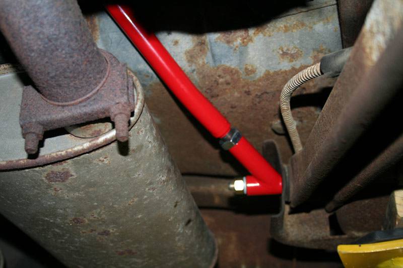

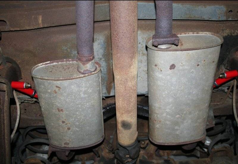

In the case of the GTO, I knew to get UMI upper rear control arm mount braces, because their weakness is a known issue and there are products designed to address that. What is available or what can be done to reinforce or rehabilitate ratty upper shock mounts in my car should it need it?
Thanks!
Bio, the biggest thing is to make sure it is solid and not torn from the frame rails. Your man can also add gussets for extra support. If he deals with the four wheelers he will know what to look fore. Read alot on this forum about this issue it's just a heads up thing. I'm sure he will inspect it while installing the rear springs etc.
Thanks @bearman !
That kind of information is what I'm looking for. As odd as it may sound, I covered something a little like that when I specced out the rear suspension of my wife's GTO. I guess having UMI offer bracing for the control arm mounts was the telltale sign that it needed to be addressed. I didn't know much about the 64-67 GM A body suspension, but once I got into it, and I was thinking I was going triangulated 4 link on my Roadrunner (but got talked into the Calvert split mono leaf springs) once I got into the rear suspension I was a little jealous. I saw a picture of the upper control arm mount of an A body GM that was twisted up pretty badly. Anyway, since everything else was UMI I got this:
(stock photo, not our GTO)
And UMI says:
"These tubular reinforcements tie the upper and lower control arm mounts together for added strength and driving performance."
So anyway, it was easy to get all of the high end and complimentary parts for the GTO, and boy did I...All to go along with the Quick Performance Ford 9" based rear axle assembly. I went all out and got the full compliment of UMI suspension parts for her car, and we are about to go with a permanent coilover conversion setup, compliments of Doug at Global West, who really hooked me up on the couple of items required to get that done.
