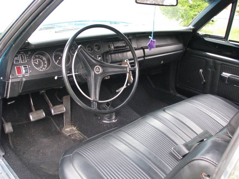

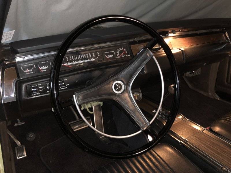

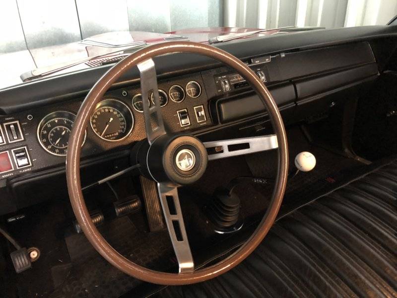

Interiors of my R/T and Super Bee.
C7F5A20E-C110-4AE4-BA4C-3697A1AD3846.jpeg A95F97D3-2DB9-4B9D-A09B-37AD7F8B5C67.jpeg
Super Bee is on top. R/T is on the bottom.

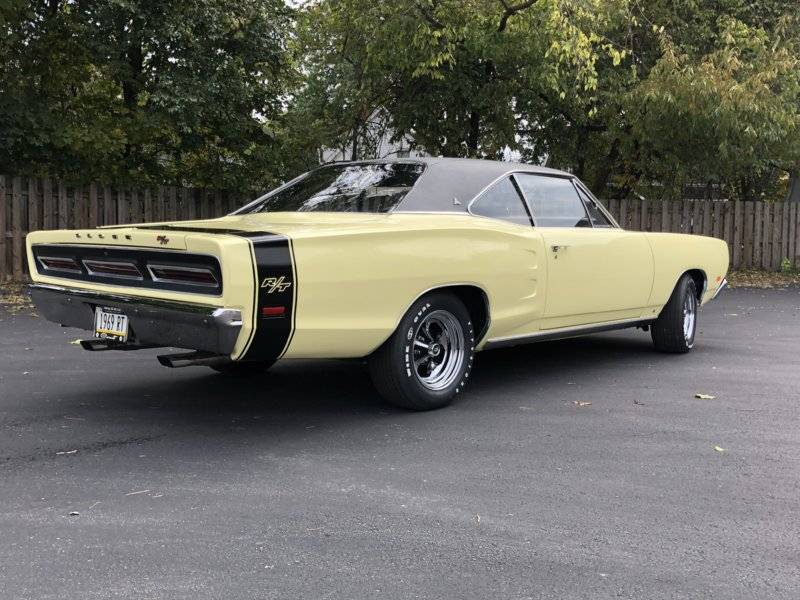

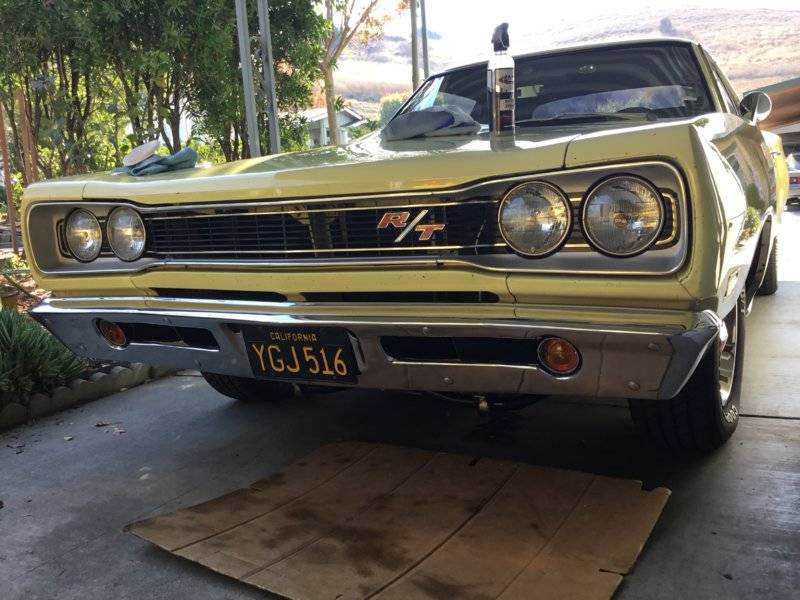

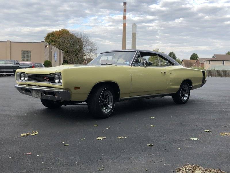

Exterior of the R/T. I do not have any photos of the Super Bee’s exterior on my iPhone. The Super Bee (lower trim level) was comparable to the Plymouth Road Runner and the R/T (highest trim level) was comparable to the Plymouth GTX.
