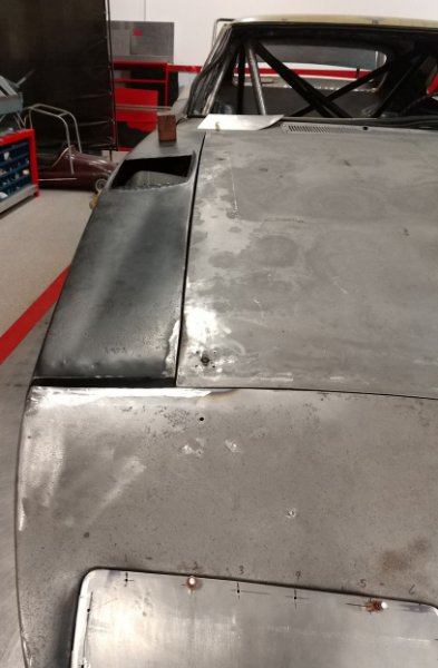

As seen, this is the ORIGINAL DC-93 sheet metal that was behind Don Whites Race shop in Keokuk, Iowa.
Rusted sections were repaired. It was a MUST DO to save the unique front end sheet metal,
since each race Daytona front clip had a LOT of hand massaging.

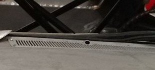

Look at the cowl photo : DC-93 has a removable cowl section so the engineers could change stuff to improve carb air
flow. Check out the bolt head/hole.
