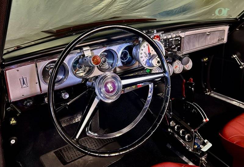

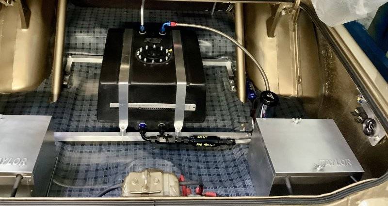

The fuel cell mounts ended up being modified for easier servicing of the 100 micron fuel filter. While in the trunk I ended up re fabricating one battery box to the same dimensions as the other. That led to cleaning up the rear wiring harness in the trunk which included removal of #8 gauge cable that previously ran up to the alternator that no longer exists. Once I was happy with the trunk area I got looking around the interior. Noticed that the top of the rear seat was getting quite sun faded and that’s when all the seats came out. They went back into place with a fresh coat of SEM and looking like new. While the seats were out the top of dash mounted tach got relocated to mid dash. The reverse lights and interior fan toggle switches also found a new home on the lower rear of the shifter riser. The decision to lower the tach is due to the air shifter and digital delay box upgrade. That pretty much takes care of off season changes. Routine stuff included Engine & Trans oil & filter changes. Also noticed a few drops of coolant on the floor over time and that led to the motor plate coming off and resealed to the block. It probably only required the water pump bolts snugged up but I had all winter so.. Had all the wheels off and a close inspection of - everything, ended up finding a right rear caliper lock nut missing. WTH. A good find. Also serviced the vacuum pump, the canister was clean & dry. The baffle that was added into the valve cover is doing it’s job. Valve lash checked, no changes req’d - good news. High speed air bleeds checked & cleaned and something a guy needs to check frequently. And just the other day now I’ve lowered the front ride height 5/8”, checked camber and tow-in with a minor adjustment. About the biggest change for this season will be the rear tire size. Previously running 29.5/11.5W-15’s. New size: 30.5/10.5W-15’s. Less tread width, a touch taller and slightly harder compound. Looking forward to a good season.

Trunk area changes made in off season

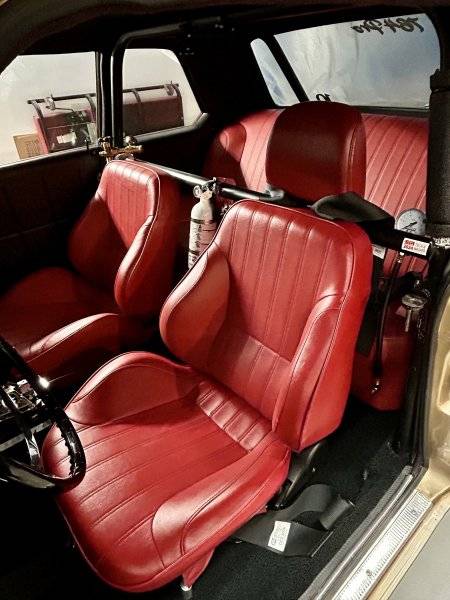

Seats freshened up. Top of rear seat bleached out from years of sun exposure at the track.
Tach lowered to mid dash and some switch relocating.

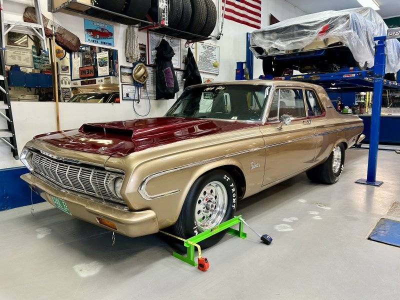

Ride height, strg alignment check.

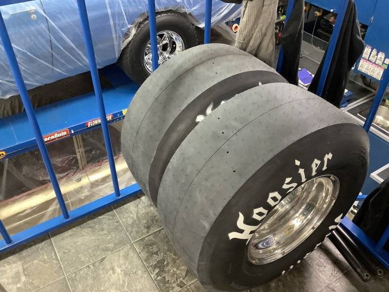

New tire size for ‘25

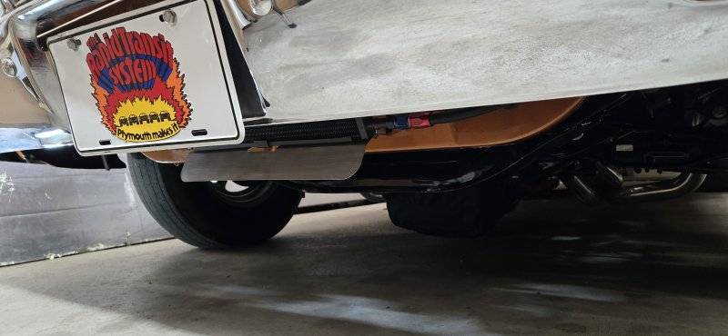

Pretty much wrapped up. Waiting for the rocker shafts which should be here Wednesday. Took the time to clean up the bottom. Not to shabby for 13 years and 1000+ passes.

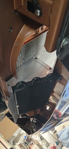

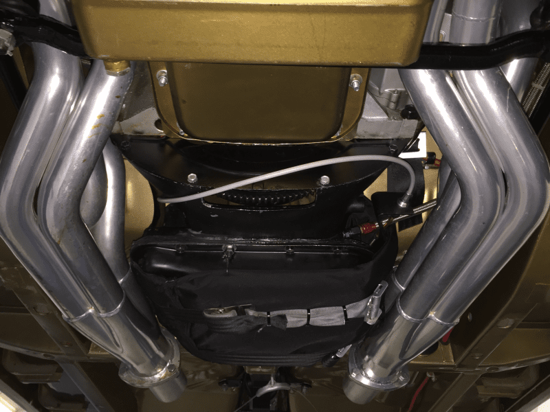

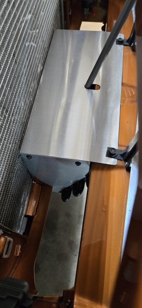

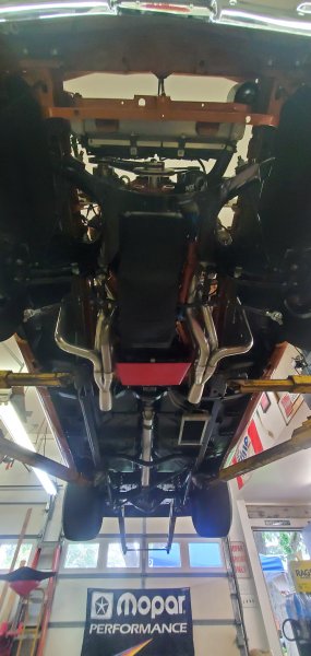

Looks fantastic and a very winning car. I presume those are Hedman Headers? And I notice your trans cooler nicely tucked under there. Any difference in trans temp there vs in front of the rad? Good luck this year!
That's actually the old trans cooler location. Headers are Hooker Super Comp 2 1/8". Here's the new cooler location and duct.

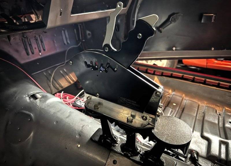

New paint and cleaner interior on my Charger. New shifter (PPP) and mount. New dash. Completely rewired. New converter. New tach. Prepping for a cage next year.

You’ll like that new shifter.

I’m excited for it. We’ve run a PPP autoshift on my Dad’s Daytona for years now. I needed a rear entry after burning up a bunch of cables with my old hurst.

Oh bummer, that used to happen to me too but I run the cable around the right side of the trans now. A 5’ cable will work with a front exit shifter but 6’ cable is best.
I ran mine similar with heat guards and built a custom housing that went between it and the header. Still ruined two cables so finally decided it was time to switch. Wish I would’ve coated these hesders like yours. You got a nice setup!
