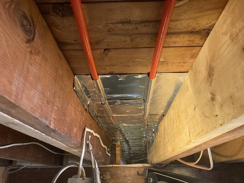

I installed a radiant heat system which I bought from a company that makes the complete systems. It is a single zone. The tubes are completely covered with heat transfer plates, reflective paper and fully insulated.

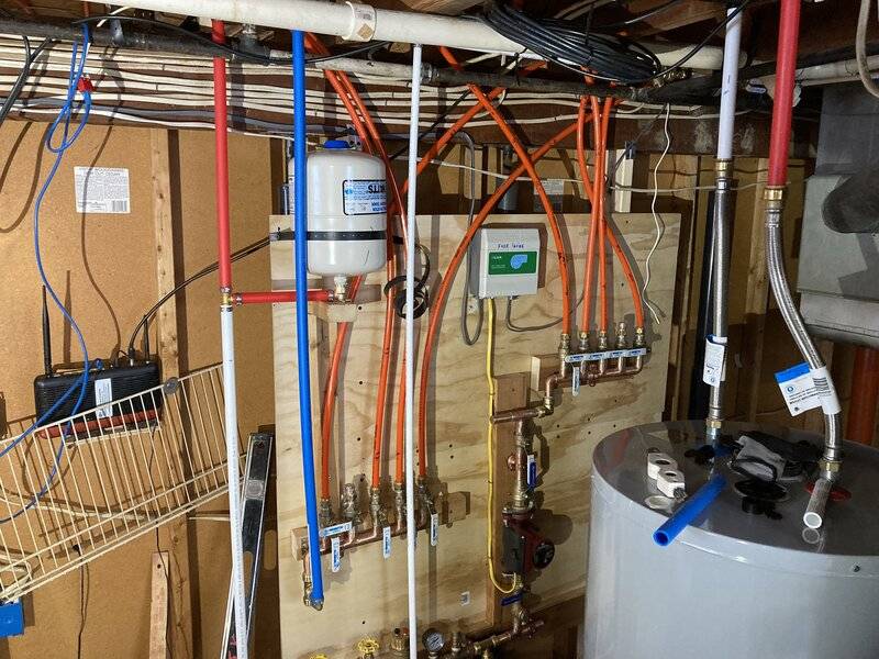

Looks like you have four zones piped in
If in future got it working properly you could put some zone valves and break it up into four zones if wanted looks like

I actually have 5 circuits (One wasn't finished when I took the picture) all approx 120-140 ft and its one zone
Im running a dedicated hot water tank. Water going in at 130 and comiing back at 115. I have plenty to go on the water heater thermostat. Also have a wall thermostat that can control ambient and floor heat

Most of your typical tank style "water heaters" will not be able to keep up with the demand once it gets cold out , that is most likely your weak link at this point . Another weak point that most people do not adequately address is the insulation under the tubing . Go to this site I have linked and do some research , even if your components are not their brand . I have 3 systems currently and have had others in the past .https://www.tacocomfort.com/product/radiant-systems/
Wow, I'm surprised they system is designed with that large or tubing and only 2 per section. Plastic doesn't conduct/radiate heat well either. Copper would be best but cost a fortune. I have multizone hot water heat and 3 zones are radiant fin tube. They need 150° or so water temp to work efficiently. I have 1 zone with cast iron radiators that works well at 120°.

All the piping is totally covered with transfer plates, reflective barrier and insulation under that.

In my opinion, running this system with a HWH will not work when the temperatures drop below freezing. Not sure where you live but here in New England it’s a hard no on this setup. If you have a boiler and want to use the tank for a storage vessel then it’ll work with the proper tempering valve.
Yup most likely that water heater being used as a boiler
I’m guessing it’s not a high recovery either
Would recommend getting a real boiler and you can put a zone to make domestic hot water also
Typical water heater is like 30/40,000btuhs
You might need double that depending on your sqft
And your loop pipe like mentioned above is way smaller trying to feed 5 loops with the same size trunk going to loose some capacity there also I would imagine
if want a much more efficient system for your application I would pipe in baseboard radiators but that’s redoing your system
The design is the issue it looks like
I don’t see no air vents or air catcher either
