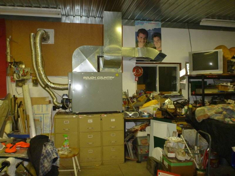

Best thing I ever did in my shop. Oil fired, direct vent/air intake and nice warm filtered air to work in now! I'll never light grammas old parlour wood stove again.
