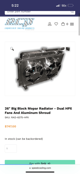

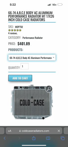

I’m looking to go with a modern aluminum radiator for my car. It’ll be driven in Texas during summer. I ordered a 440 source water pump and housing. I hear electric fans are better for traffic. I have an original mechanical fan as well. What would your advice be? I know cold case is thrown around a lot. I did also find one with electric fans for a seemingly decent price online.

I have the Cold Case MOP754AK Works great.

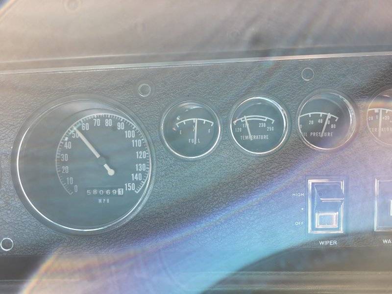

I keep sayin it, but nobody wants to listen. Almost 30C here today, cruised 5+ towns on a 90 mile cruise holdin up traffic in first and second gear. 426 Hemi, factory correct radiator for the '66 and a 7 blade, curled tip OE fixed fan from a '68/69. Ran FIVE degrees above the 190 stat all day long!

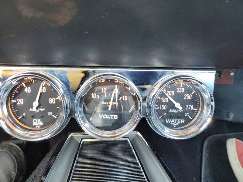

But it gets MUCH hotter in TEXAS :) , my junker runs 185ish all day long 108 degree day with the Cold AC on, ECP 2 row radiator & 4000cfm Derale fans & shroud
