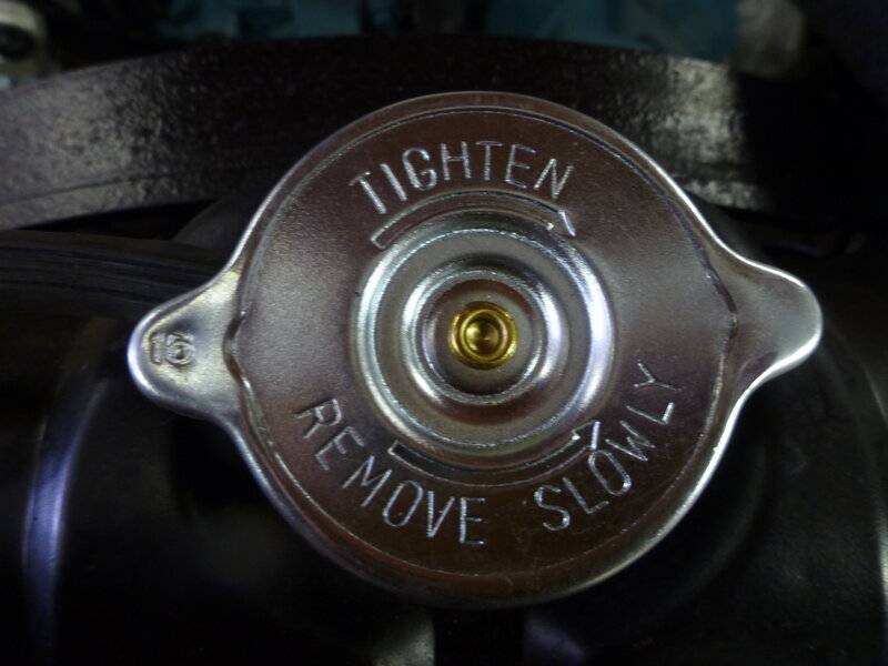

I have a Stant SP-9 7lbs lev r vent cap on my 69 charger RT 440 is that the correct cap?
No, on a stock radiator it should be a 16lb. cap.
Not correct as far as originality but it should be fine. The pressure just raises the boiling point of the coolant. Having overheating issues?
Richard has the correct small rivet '69 and prior caps available now. www.restorationpartsandmaterials.com
I think those lower lb caps are designed for aluminum radiators.
