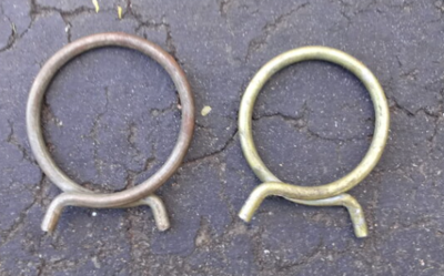

Hey guys. A few weeks back I installed all new hoses, I use the OEM style spring clips. I was hoping that as the hoses heated up so too would the clips and in so doing would slightly melt into the rubber making the clips tighten better.
Well I have 2 small drips & can't seem to get them to stop. I'm assuming I can use some type of silicone sealant around the outer edges to eliminate them but was wondering what you guys have done.

The Corbin clamps or any other kind will never get tighter with heat. Just the opposite will happen as the metal loses its temper with heat. Worm type for sure is the way to go for positive seal. Also check your radiator cap holding no more than 16 lb. psi , and does not bleed down. Corbin clamps were very quick to install on the assembly line. You don't see them anymore for a reason.

I've not had any problems with the Corbin clamps, but I am looking for origionality, as this what was factory installed. YES.....worm gear type clamps are superior as far a holding power but are easy to overtighten if not careful. The other style of clamps used by GM and Ford were Whittek or "tower clamp" style....effective but difficult to release when needed.

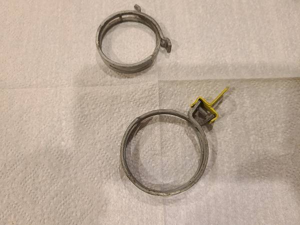

Yep, today switched out the older 2 clips with the newer ones on the upper hose. Went out for a nice long drive and checked under the hood when I got back, no leaks, Whew!

The factory still uses spring clamps on new cars. These are for my 07 srt charger.
