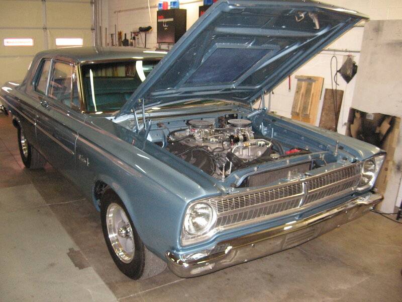

Jegs has some heavy plastic ones.They come in colors,I got black for my 65. It fit between the rad support and grille on the battery side. They mount with 1/4'' bolts. They have thread-sirts molded into the tank. I looked for photos that may show it on my car.You can't even see it.In the photo you can see the hose on top of the tank running towards the battery and barely see the top of it. I did have to drill 2 holes in the rad support to mount it.

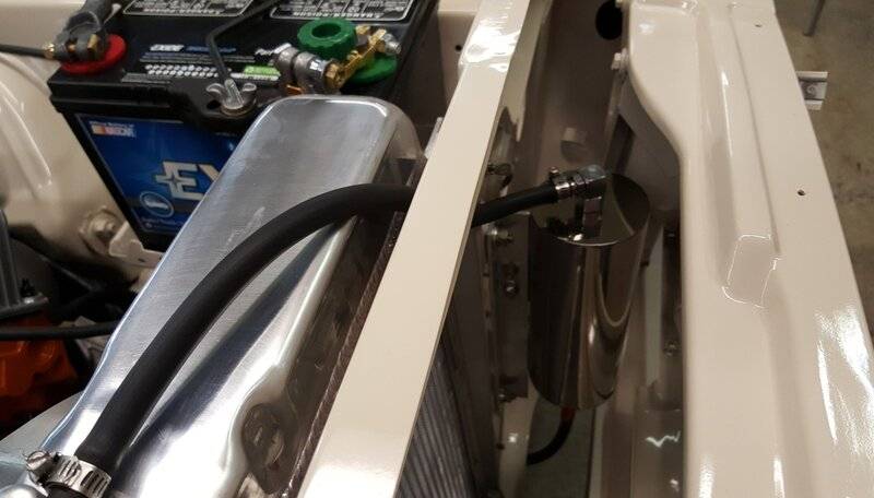

Looks like the same one I used. It's really a catch can. You'll just keep filling it if the cap isn't holding.

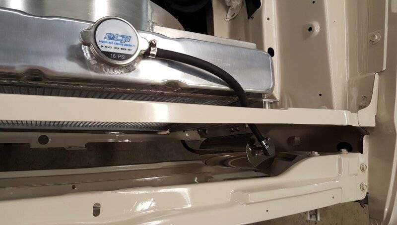

Nice, that's clean. Smart to install in front of the rad support, plenty of room up there!
I ran the radiator overflow hose to the bottom of the can so it will fill from the bottom and suck the coolant back out when it cools (I hope). The top port I use as a drain, so if it ever goes over 20oz it will spill.
Jegs has some heavy plastic ones.They come in colors,I got black for my 65. It fit between the rad support and grille on the battery side. They mount with 1/4'' bolts. They have thread-sirts molded into the tank. I looked for photos that may show it on my car.You can't even see it.In the photo you can see the hose on top of the tank running towards the battery and barely see the top of it. I did have to drill 2 holes in the rad support to mount it. View attachment 1117265
Damn... that is a freakin' beautiful car..........
