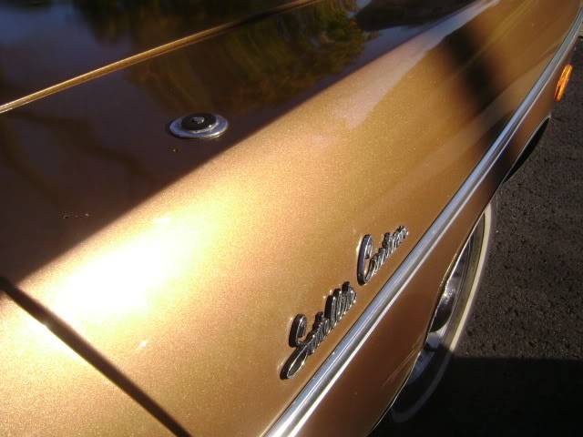

Depending what year,some did have plugs in the fender.
My 73 wagon is radio delete,and has a fender plug...
