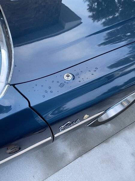

So not technically a radio delete--more correctly not optioned with a radio?
I'm 99% sure my Cordoba came with no radio from the factory--
1) No radio code listed on fender tag
2) Previous owner hacked a DIN size opening in the lower dash panel
But, my car also has an antenna base that looks very factory installed
I haven't located a broadcast sheet in my car yet--that I feel would solve the case.
My questions--anyone else have a late model B-body with no factory radio?
Did you still get a factory antenna installed with no radio?

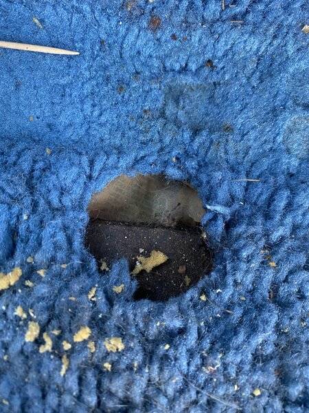

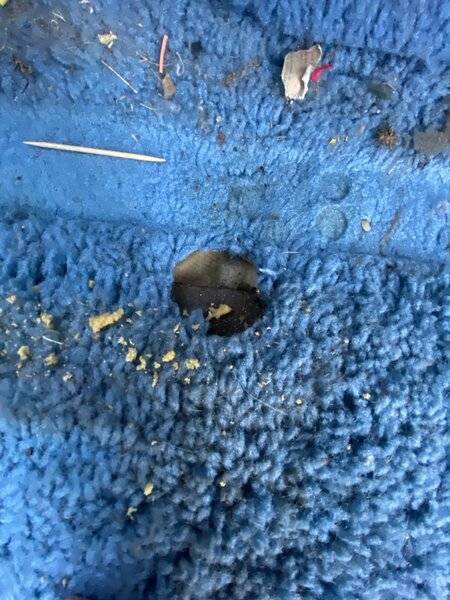

On my '77 Cordoba I found it under the carpet of the passenger side seat.
Finally found my broadcast sheet today!
Mine was under the driver side seat--spotted it through a manufacturer hole in the carpet ;)
Totally confirms no radio was optioned for this Cordoba--very cool to me--considering it had so many other options!

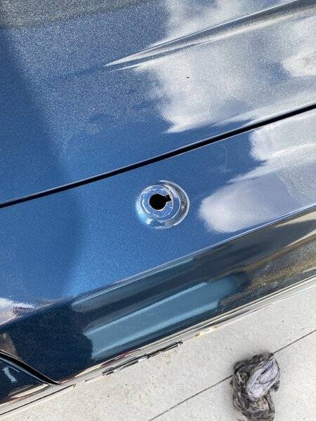

Today I have pleased the MoPar gods by returning our Cordoba to the factory non radio/antenna spec! :lowdown:
Seriously though-- I repaired the lower dash panel a few months ago and was just able to buy the correct fender plug recently.
I do not plan to keep this Cordoba completely stock--but this just seemed so rare I had to lean into it. :thumbsup:

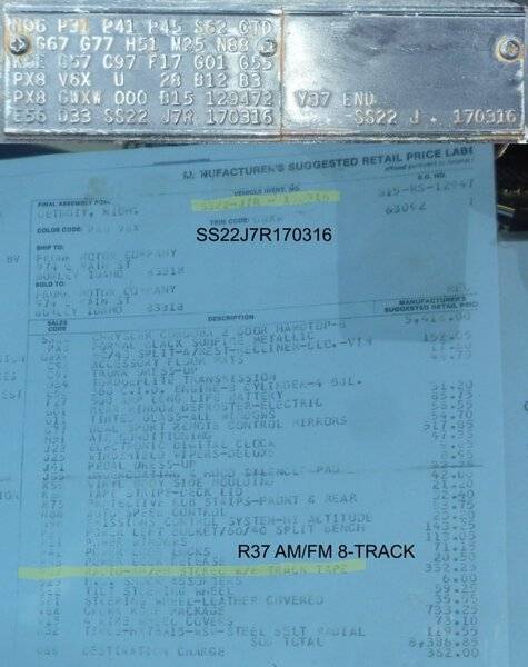

You don’t need the broadcast sheet, the tag tells you the story.

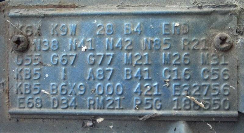

Interesting coding quirk from that era...I think if you look at Windsor built Cordobas and Chargers from 75-79, you'll find NONE of them code a radio on the tag.
R37 on window sticker. Nothing on the tag.
I have an 80 D150 that was a radio delete and had an 83 Rampage radio delete also. I always thought the antenna plug looked kinda neat, like a power antenna fully retracted.
Never say 'never. Not often is a better choice.
(((Tags from 75 runner, 78 Magnum, 79 Magnum)))
I have at least a half dozen that I (strangely) don't have pictures of fender tags, maybe another example there?

R47 Power antenna
R32 Dual rear speakers.[/QUOTE]
Shoot, that's on me, I was just looking for R codes. Then I did read the wrong line in my white book three times, I kept reading R37. There just aren't very many codes past the P's on most fender tags I have. I guess it's like the Mayan calendar, probably doesn't mean much more than they were running low on room.

R47 Power antenna
Shoot, that's on me, I was just looking for R codes. Then I did read the wrong line in my white book three times, I kept reading R37. There just aren't very many codes past the P's on most fender tags I have. I guess it's like the Mayan calendar, probably doesn't mean much more than they were running low on room.[/QUOTE]
It's not an issue of room. More likely that plant coding philosophy dictated codes using those letters simply were not coded on a tag and codes using previous letters were. If two tags were necessary to communicate the required info, two tags were used.
