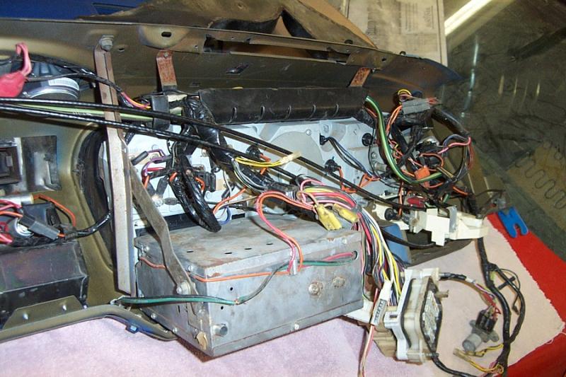

Here is a pic of the backside. Radio strap goes to the dash strap. Can't see the side screw in the pic but is front of the long strap next to where my speaker connector is sitting, I think, been awhile. May be higher. Pull the housing and you'll see where is goes.

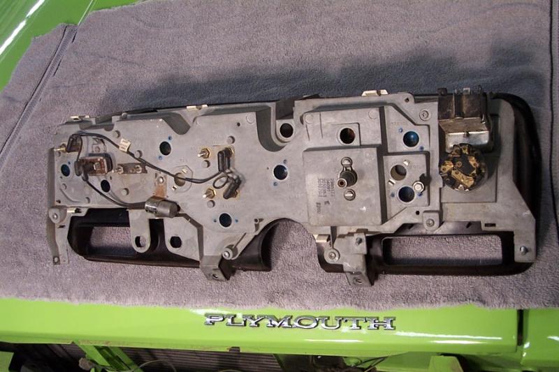

Here is a cluster. See the leg with the hole hangging down in the lower left? Thats where the side screw goes.

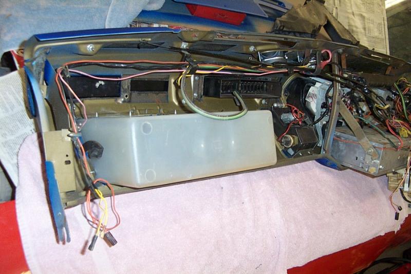

Here is another pic. See it next to the ash tray?
