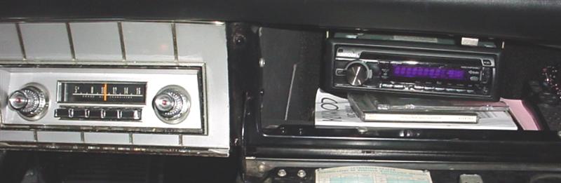

I just installed a glove box radio in my 65 Coronet. You can pick up all your feeds in the fuse block. The red wire goes to a switched terminal, (you can use the original radio feed there.) The yellow wire connects to a constant hot terminal, (there are several in the fuse box). The black is a ground to the body. The orange wire on your original radio is the dial light, which is usually connected to a switched power terminal but can be intergrated into the panel dimmer circuit. The red connects to a switched and fused terminal. All you really need is a test light to determine the source terminals.

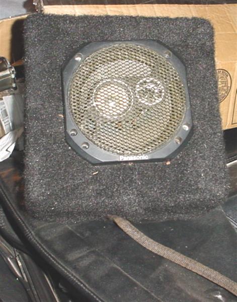

To acoid cutting into any interior parts for speakers I constructed two wood boxes, lined with styrofoam inside and mounted my 5" 3way's in them, then covered the boxes with carpet. I routed my speaker wires behind the right kick panel, under the sill plate and carpet and under the front seat. I used about 10-12 feet of wire so I could place the speakers where I wished, (even outside the car) and used RCA plug connectors so that I could remove the speakers altogether if needed. It sounds great....!!!!

I purchased a reproduction glove box liner for my radio mounting conversion. I used a "U" bracket bolted to the top of the box liner to suspend the radio. A slot cut into the back of the liner allowed the radio to fit further into the glove box. CHECK the clearance behind the radio for your wiper arms..... !!!!!!I had to mount my radio all the way to the left to avoid interference with them.
