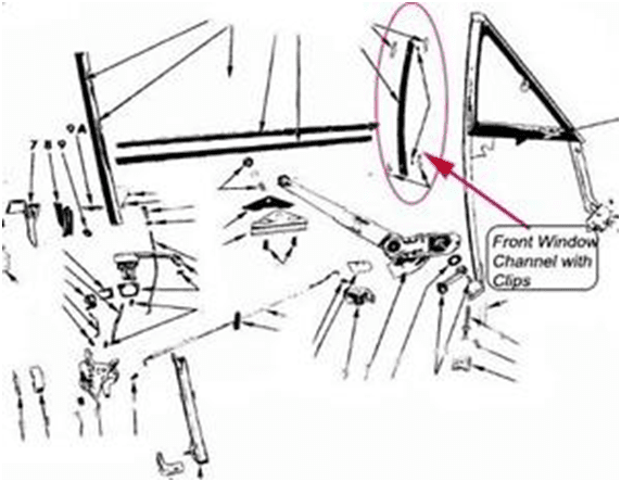

I'm working on a very similar issue with my windows right now. Anyway, here is what I "think" I know...
1. I don't believe the convertible DOOR window mechanism is all that unique....maybe the little "triangle support" for the front vent window frame "leg", but that's about all I've seen.
2. The door glass does have in/out/front/back adjustments BUT, the glass is only pushed up/down by a single point (one roller at the end of the regulator arm inside a "slide" attached with one plastic rivet in the center of the glass)….so it's not like "the front half is pushed up more than the back half" (make sense?). It's almost dead-center in this picture below
3. The glass slides up/down pretty tightly held (front) in the front window channel "mylar" felts (circled in picture above) and sort of "loosely held/guided" (back) in the rear run channel seal.
4. That roller "slide" I mentioned in #2.....The top of that piece is what attaches to the glass itself with a single plastic pin & the glass can rock back/forth slightly. There's an oddly-shaped paper gasket of sorts that squeezes in there, but the glass still has some front/back/tilting "slop" in it. (I considered window glass adhesive tape here, but didn't use it. I think it's important for the glass to have this little bit of "slop" so it doesn't jam.)
Now, my guess is what you're dealing with is a couple things.
a. Something in the back of the glass is hanging it up a little bit.....rear channel seal itself, rear channel seal frame out of adjustment quite a bit, or ?. Maybe just a shot of silicone front & back where the glass slides?
b. The "up stop" of the glass probably will need to go up a little bit (maybe not?)
