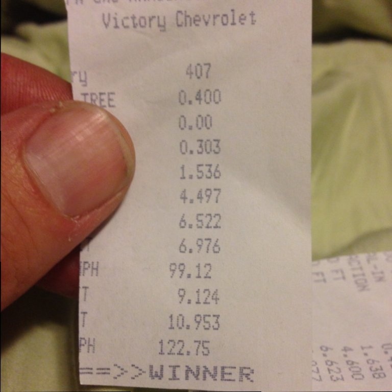

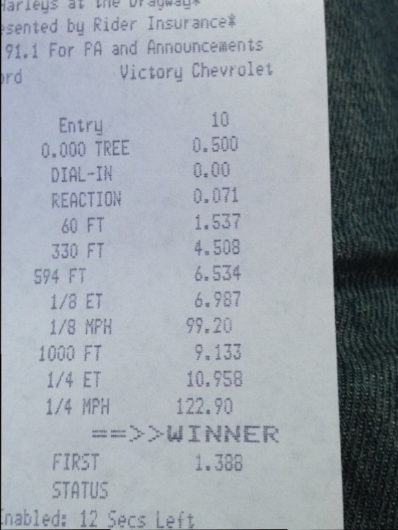

Took the roadrunner out today with a 1050an on a tm6. It's pretty damn close to the six pack, may have squeaked a bit more if I would have jetted up. I leaned it on the hsab 1 size to see where I was at and it slowed down. All in all it was a good day, drive it to the track, hammered it, and drove it home. It was "no et" day so I didn't get bitched at. I would have made more passes but the track was getting questionable about midway down so I called it.

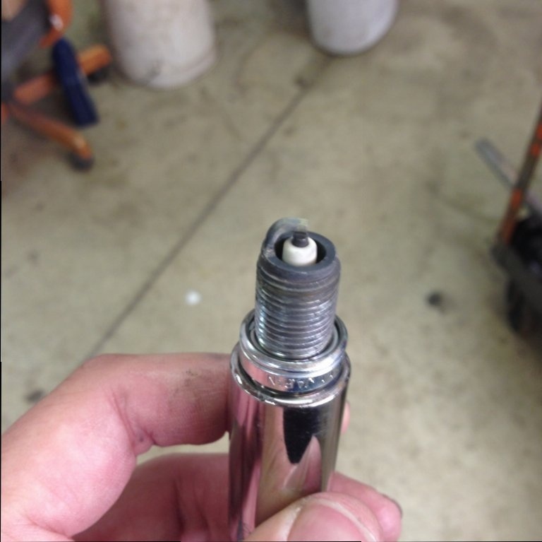

It was, I've spent quite a bit of time fiddling with both setups using a wide lm2. So the tune ups are very close. I was really surprised at the time slips, you could lay the 10.95 slips next to each other and think nothing had even changed. Curious what a modern single plane would do, but not 300 dollars curious... lol. I really do like the double pumper on the street, I spent a lot of time cleaning up the cruise on that carb. It was pretty fat to start with. I moved the idle feeds back to the bottom of the metering block and reduced the size. I also added screw in restrictirs to the transfer slots. Plugs look excellent.

That's was my point, most people are satisfied with that. I am not. Just because your running a big carb you shouldn't settle for dumping excessive fuel in the motor under cruise. I don't care about the mileage as much as washing oil off the cylinder walls and shortening the life of the engine. If I would have just left the 1050 alone it ran fine. But when it's cruising around at 11.5-12.1 afr I knew I could improve upon it. It took work but I got it there. Runs good, it's clean, and the mileage is a bonus!
