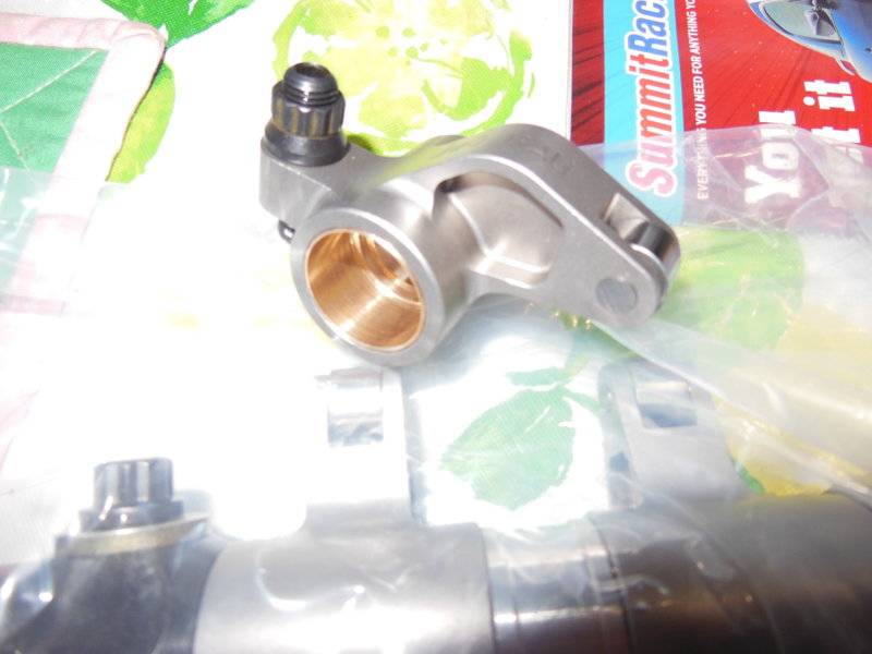

bought some new rockers today for the upcoming 426 wedge motor currently at the machine shop..there from RAS..carrol Shelby used the ford versions on a cobra with 950 lbs spring pressure according to them ,,SS bushed with smith brothers adjusters..generic photo from the web..have used them before..bulletproof..

heres a better pic of these rockers...they now have inventory after 2+ years...

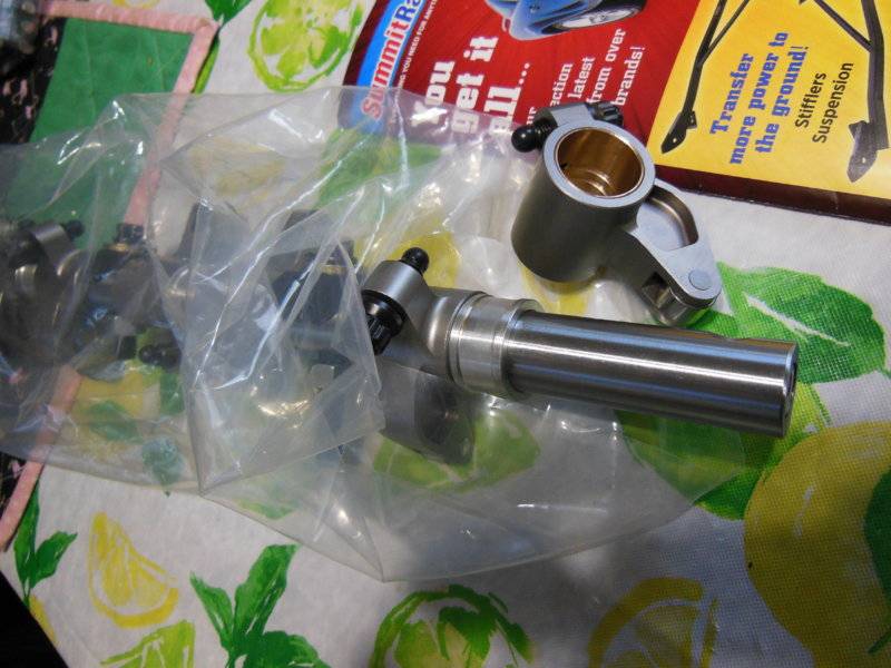

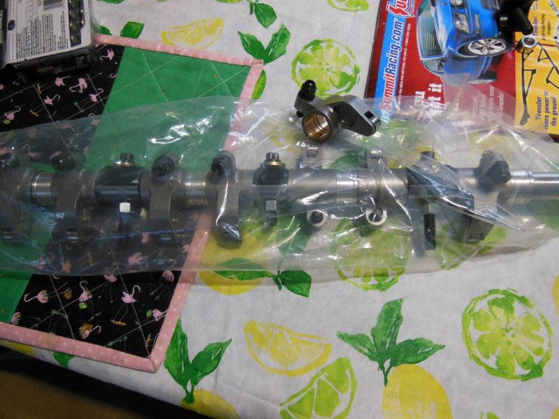

just received the rockers...very nice..bronze bushed..with smith brothers adjusters..
Look pretty damned robust. Me likey. Congrats!
Is there a choice of adjuster style, or is it ball only?
Inventory was always a little iffy with them. Glad to see them back on their feet... again.

inventory was good last week...u can have either ball or cup..they suggested ball for oiling reasons..which is what I have...retains some oil at all times..cnc machined stainless steel..

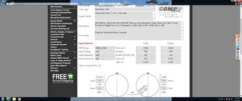

these new 1.6 ratio RAS rockers r going to change my lift and duration .. how will that change my final numbers..both lift and duration,,and at .050..blurry pic..lift is .650,,.651,,,,.296--.303,,,@ .050.263--.270,,,108 center..based upon 1.05 stock rockers..
Same cam I’m running, lift will come in around .693/.694 not sure how the 1.6 effects the duration numbers someone will chime in.
according to RAS,,when using 1.6 ratio arms..because of the lash , u will end up at a true .650ish lift.. if the arms add appx .033 lift above the stock 1.5 ratio,,,minus .028 lash gap,that would be .655,,,duration on the other hand is a completely different formula not currently at my fingertips..
