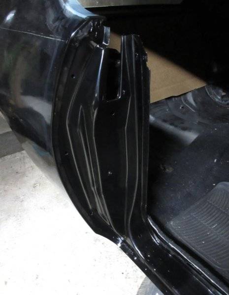

Here's a door jamb I painted with Duplicolor lacquer -
That is plenty wide for striping. It isn't as tall as the roof is wide though. I'm doing a test now to see if I can get smaller sections to blend together. I tried earlier on a different panel, when I was testing to see if I could match the MAACO paint. The Duplicolor blended in great with the original paint. I feel like I'm cursed with the roof and dutchman panel, but perhaps I'll manage to "crack the code" yet.

Yes enamel will stay open much longer and give you less tiger striping . Enamel will also take a lot longer to fully cure.
As far as the door jam, it has tons of angles and different lines. Not the same as painting a big flat section of the roof that is at eye level for you see at every angle
