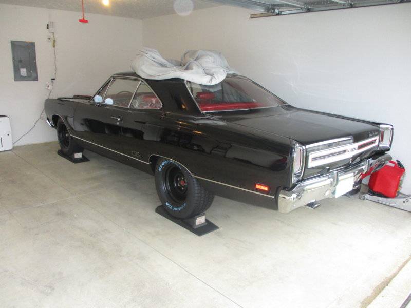

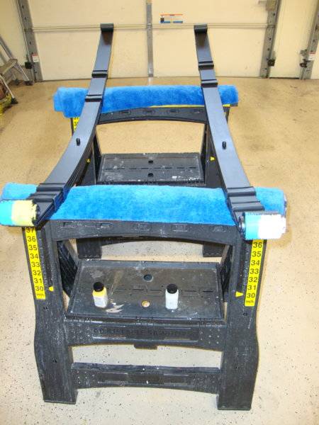

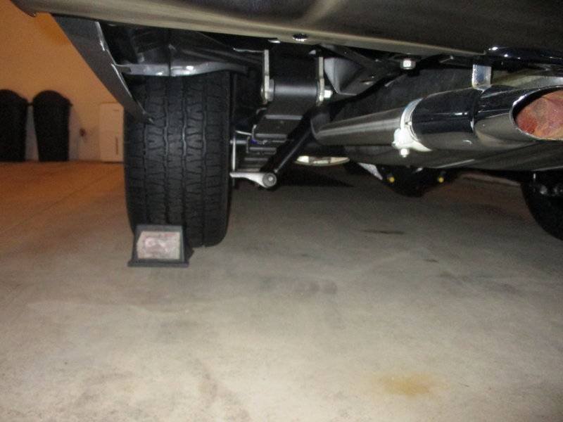

My Charger has ESPO springs for over 10 years......The GTX has Eaton springs, just a couple years.....

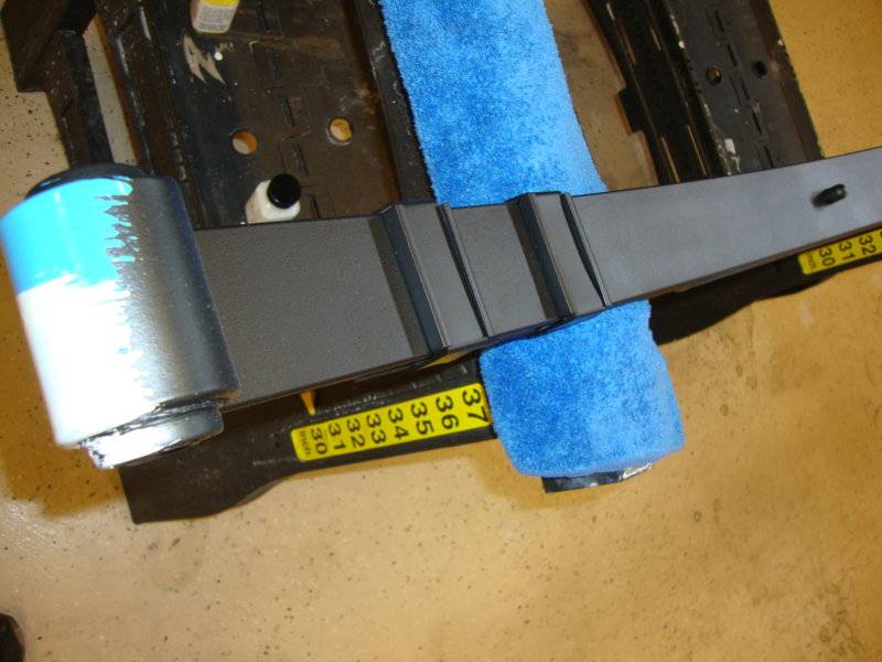

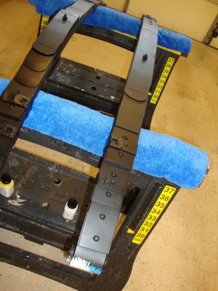

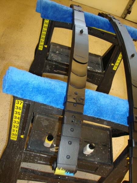

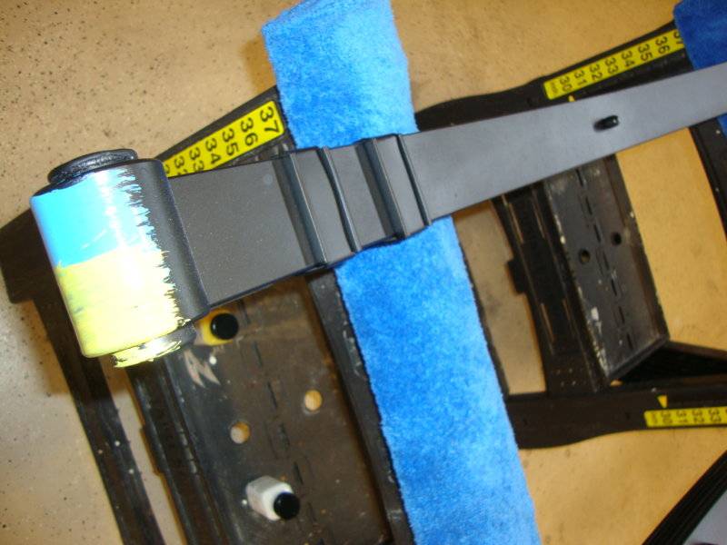

First set of pics show the eaton springs and to make them factory correct requires a little work and a few leaf transplants from the originals. Pretty much the same process for the Espo's......Liners, pads, insulators and brackets are from Frank Badalson and the eye bushings are NOS.....

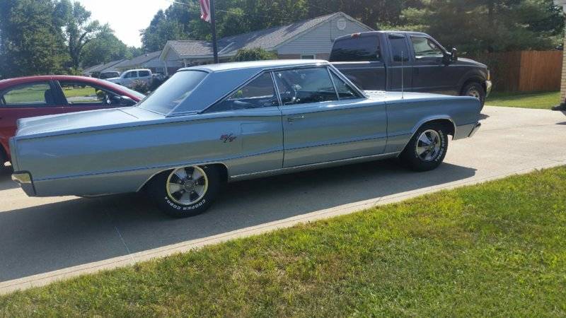

Higgins car is a beautiful ride and I love the car but the springs are flat....My observation.....I was quoted in that post, right? Had nothing to do with the rest of the car geez......
