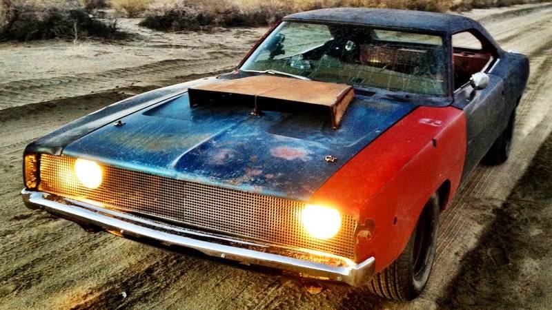

I have sold my 68' charger, but I wanted a cheap basher for desert blasting so I don't care if the car is 100% blended, or perfect. Here's my question, if I bought a cheap manual 2008+ challenger, and then bought the AMD 68 panels and placed them on, would it be a reasonable look? I checked the wheelbase, a 2008 challenger is 116" and a 68 Charger 117". Would it be a big job? I'm hoping it's just weld those panels on.
I don't care if it does not withstand inspection from a general look? as long as the lines are pretty much ok, I like the 'roadkill' version, so as I said, the panels would not need to be perfect as it's a rat desert look.

The roadkill car is actually a real 68 with a hellcat engine. Its not a skinned charger. Now there is a post here somewhere with a reskinned challenger that is done with carbon fiber panels. I dont think off the shelf panels are going to work for what you have in mind.

True, my reasoning is, 1" difference in wheelbase, not too dissimilar in general shape and the fact that I want a rat desert look so flush perfection isn't necessary for me.
