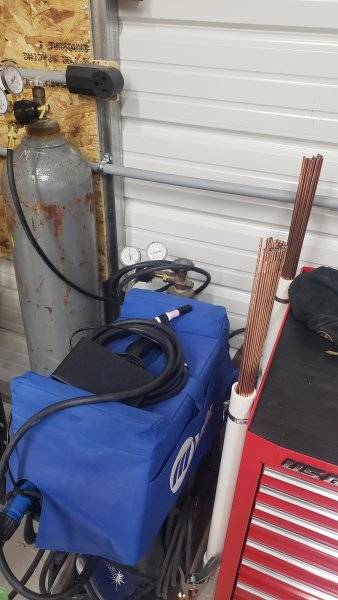

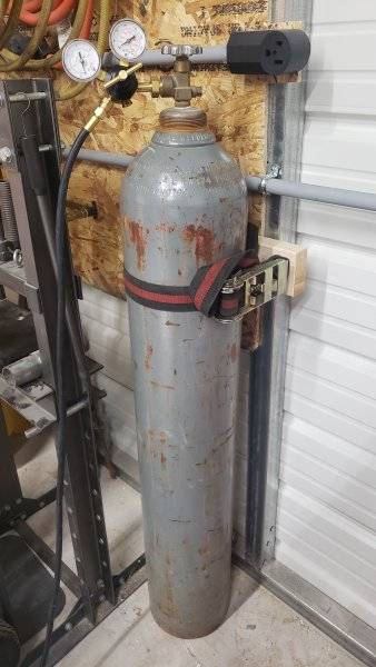

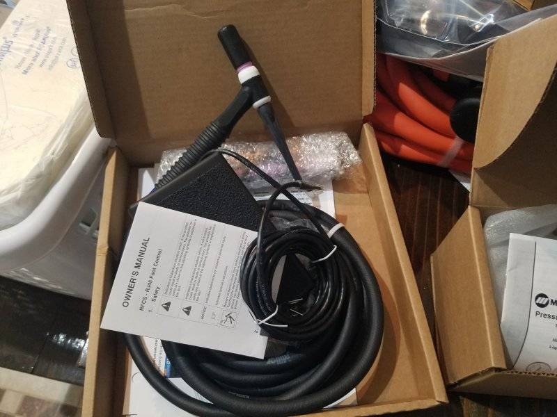

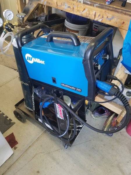

I've had my Miller Multimatic 215 for a couple years and I finally got some filler rods and a huge tank of argon to start playing with it. I ordered the tig kit when I ordered the welder.

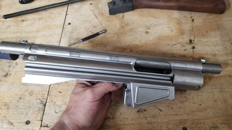

Bent up my receiver flat today in my homemade jig. Going to become a semi auto Cetme rifle. All the seams will get tig welded and the barrel trunion will get rosette welded.
