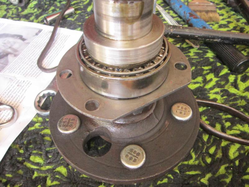

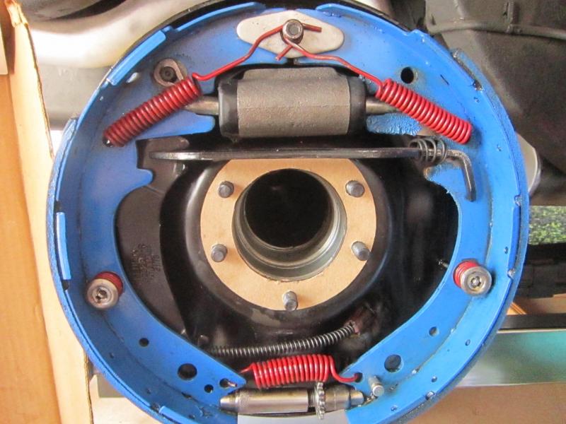

well, i finally got the inner seal out, and let me say, it was hell! The leaking problem must have started due to a lot of up and down play in the axle bearing and the housing. So I have a new Timken set 7 with 2 new seals on the way. I made my own gasket for the axle flange. Once I get the parts, I will take to a friends shop that does trannys and drive axles. IMG_2642.jpgIMG_2639.jpg
