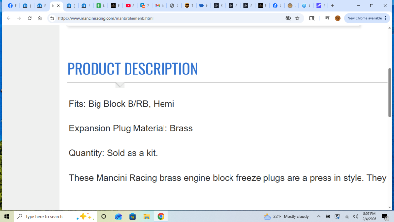

Mancini has them in their freeze plug kits. Contact them and see if they sell them separately. MRE - Brass Freeze Plugs

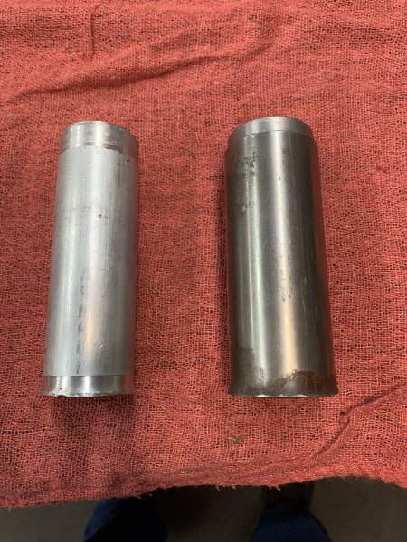

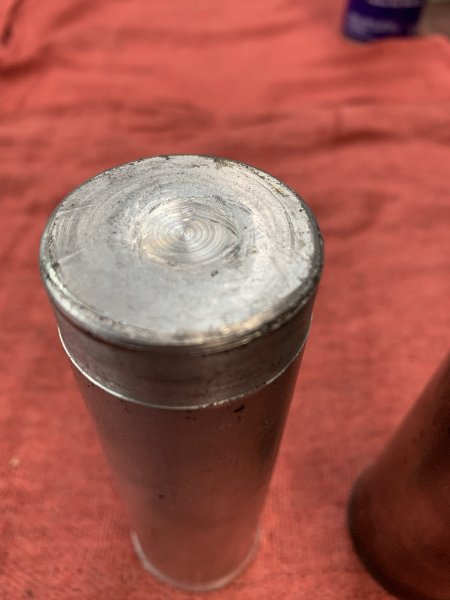

The flat disc plug you need is EP-44 2 1/8" Mopar PN#1852177 You MUST be careful not to push the middle of the plug in to far as it WILL rub on the cam. The action of flattening the curved plug will push the center in too far. I have made these tools with the center relieved to install them and not push the center in too far. Also, if you install the plug too far, you end up removing the pressure exerted by the outside circumference as it will pull back. This is how they are removed, smack them in to release the pressure and use a slide hammer (dent puller) to pull them out.

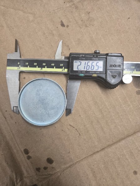

Thanks all for the info. It seems that a lot of these plugs spec out at 2 1/8 inch (2.12) as opposed to 2 9/64 inch (2.14). A total difference of 1/64 smaller. Would you see any fitment issues using these 1/64 inch smaller units? Upon install, will the cup expand enough to fill this undersize?
I believe so. Put a little amount of sealant in the recess before the plug.

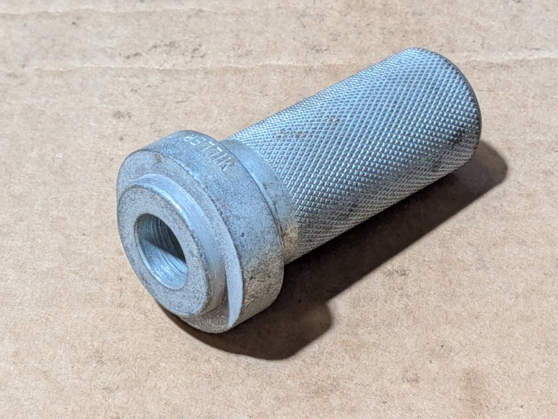

    3. Chrysler specified Miller Special Tool C-897 to install the plug.
  5. Drive the plug squarely into the hole. The shoulder on the driving tool should bottom out on the part the plug is being driven into. This will control alignment and proper depth.
    NOTE: If driving without a formal tool, without a shoulder stop, use something round with an inset in the middle and drive squarely while approximating the flattening to be about 30%. Do not over flatten. See post #11 for a fabricated tool and note the usage.
  6. If the engine is disassembled, tap the plug from the other side with a wooden dowel to ensure it is wedged tight.
Tool C-897 looks similar to the following image (this is not the exact driver though):
Thanks for this. I'll probably make something similar.
