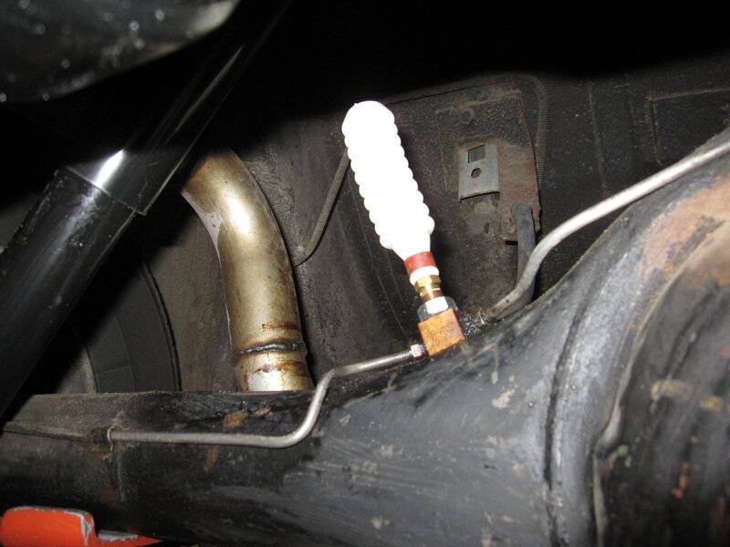

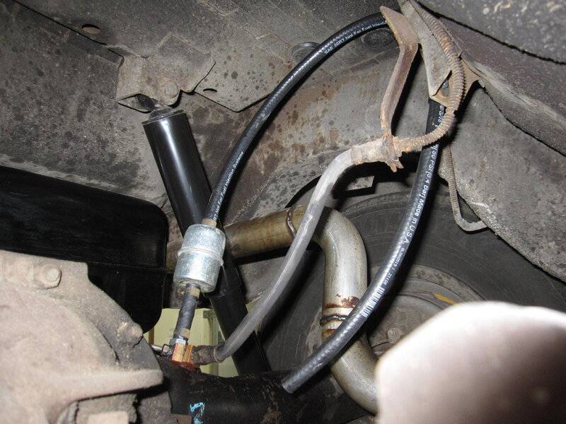

      I tried a long hose tied up as high as I could. Still leaked. I put a fuel filter in the hose at the end-still leaked. I finally solved the issue with a bellows. They sell them for off road vehicles. This was on my 65 Coronet-bone stock rear axle.
      Mike
