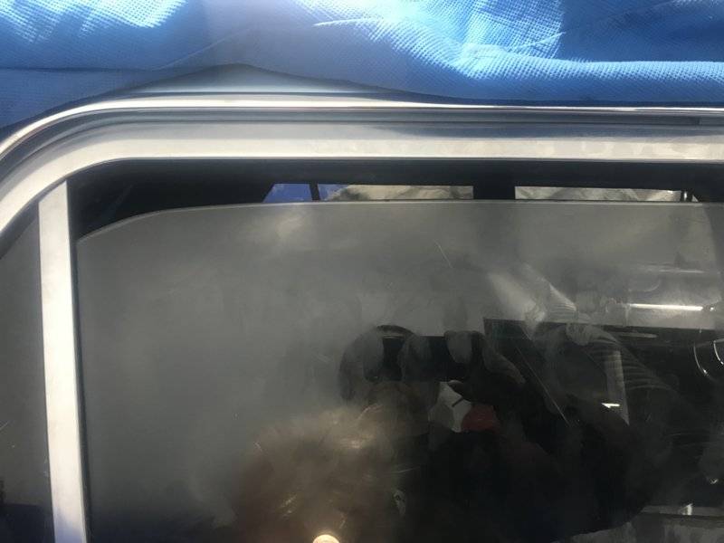

i just replaced the back door
Glass wheather strip
On my sedan
But the passenger glass doesn’t
Go up all the way
I did not notice how high it went before replacing the rubbers
The drivers side is fine
I’m thinking that the glass is from a later model or maybe from a coronet in something
Does anybody know if there is a slight difference in the glass from year to year
It can’t be the adjustment there’s none and the other side went fine
I think it’s the wrong glass
Trying to see the number on it
Will need a magnifying glass

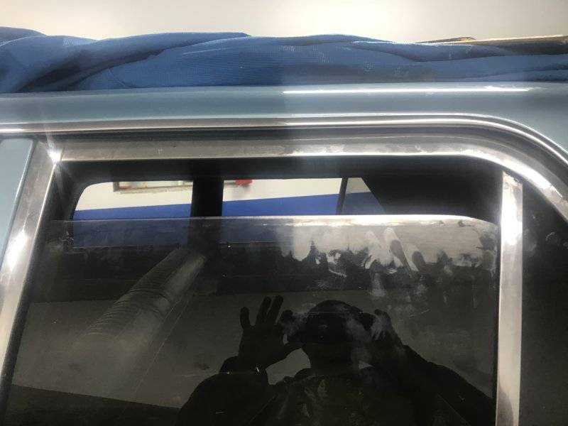

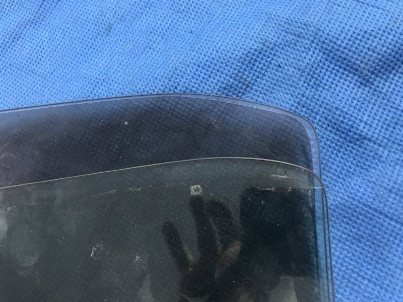

Here is both rear windows
One is more curved than the other
A2A2FAB2-7EF2-4647-8FA7-F41DB0A0FB1D.jpeg 91FFD4D1-BB80-43B3-BF8C-0F89E7C91169.jpeg
Sure looks like the wrong one, something is off.
Dodge and Plymouth of the same year and body-style....would use same glass.

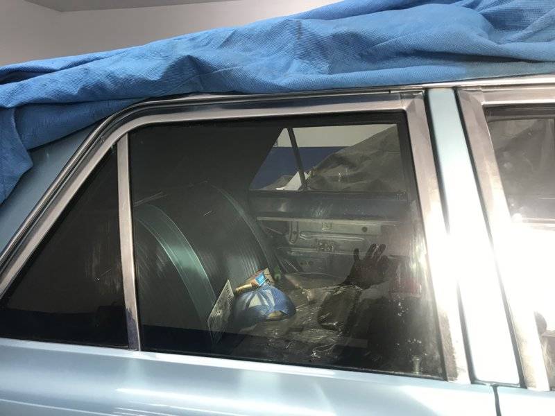

Thanks uncle Gerry for getting me the proper glass for my b
They are almost the same
But some where along the way they must of put in a later year or earlier glass
Always had a whistle coming from that side
No more
