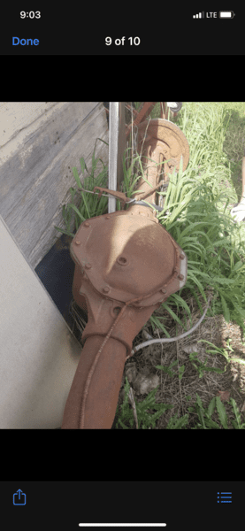

Can someone answer if this is an 8 1/4 or 8 3/4 rear end? I thought the 8 3/4 had the bolts on the front with the whole gear assembly being able to come out. This I would suggest is an 8 1/4. Looking for advice. Thanks all.
Not a 8 3/4.
Could be 7 1/4, 8 1/4 or maybe even 9 1/4 depending on physical size.
Absolutely certain it is NOT an 8 3/4 (nor a dana 60). Never having had either an 8 1/4 nor 9 1/4, i cant be sure, but i think (think!) It is a 9 1/4. If it is, it is an excellent, strong rearend, with virtually no hop-up parts available. (In other words, aftermarket gears and suregrips virtually nonexistent).
It is a 9 1/4. Google "mopar rearend identification chart".
Edit. Did some research, parts are available for the 9 1/4 twelve bolt. (Do not confuse with gm twelve bolt). Surprised me!
Motive gear has gear sets from 3.55 to 4.56, and Yukon gear sells a dura grip lsd. Gears and a "posi" will run $850+.
Jerry, thanks, I couldn't find that chart quickly. I completely forgot that the 8 1/4 had the obround cover.
9 1/4's are very strong. If it is a factory limited slip, would be outstanding.
I was told it was from a 74 Station Wagon. I really appreciate the fast response from you guys! I'm considering buying it "to put on the shelf" should I ever need a rear-end swap. What's it worth given the gears are unknown? Seems to be posi. Again, details are quite vague from the seller.
If it is a "posi" (there are fanatics here that will crucify you for that, its a "sure grip" ) and it turns, its easy to find out what gear it has. Just turn the pinion till an axle makes one ful turn.
A sure grip with 3.23 or 3.55 is worth a bunch more than a 2.76 open, especially if it is a bolt in for your car.
Compare drum to drum widths.
