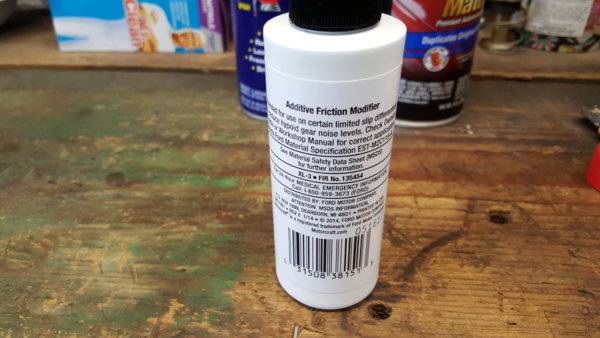

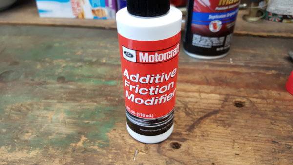

Along with the gear oil what additive do you guys put in your rear ends ? Any sure grip additives.
Mopars got one, don't know if they still make it?
As per Dr.Diff, in clutch type...
I've even used a few ounces of STP in the Track Lock crap LSD's and it worked better than any over the counter crap did....
