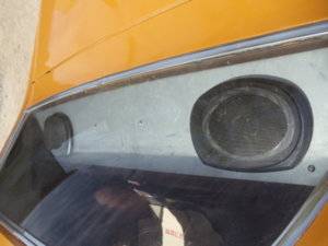

When I saw my package tray was disintegrating, I decided to upgrade to a better grade material--stainless steel (a local restaurant sink fabricator made it for me). I have backlight louvers that shade that area, so I kept it in its "raw' state.
You will still need 1 speaker grille, motor goes under that speaker grille, for the motor to draw interior air to defog the window.
