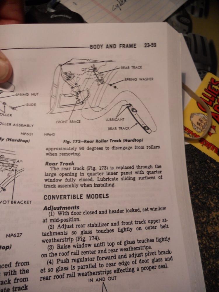

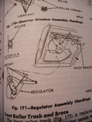

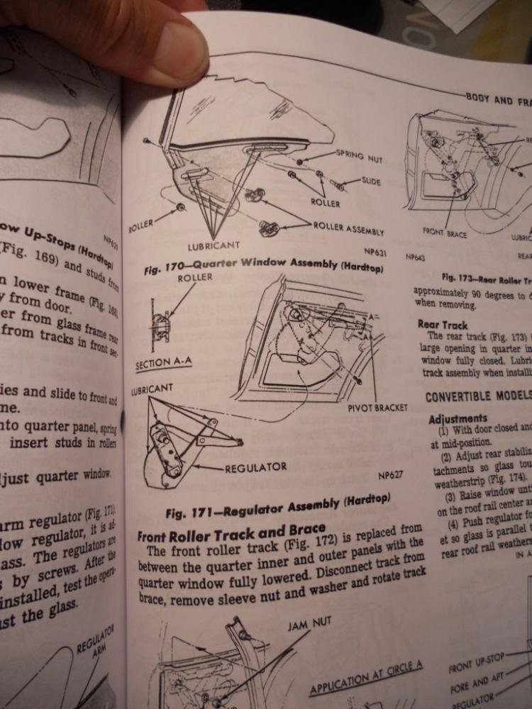

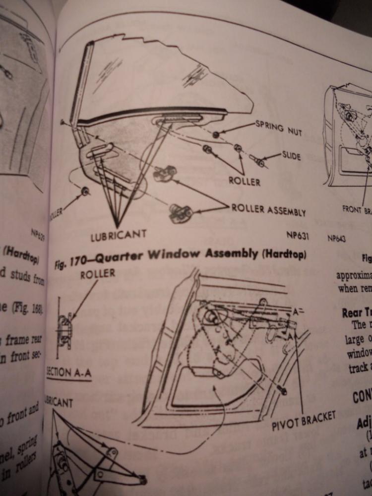

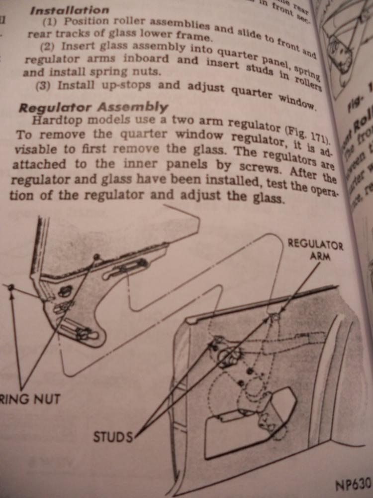

By no means a "factory line worker', but have fought this battle before. It's a lot easier with the factory service manual. Here are some pics from my '68 FSM, I don't have it on a disc, so this is as good as I can do. Good luck!....

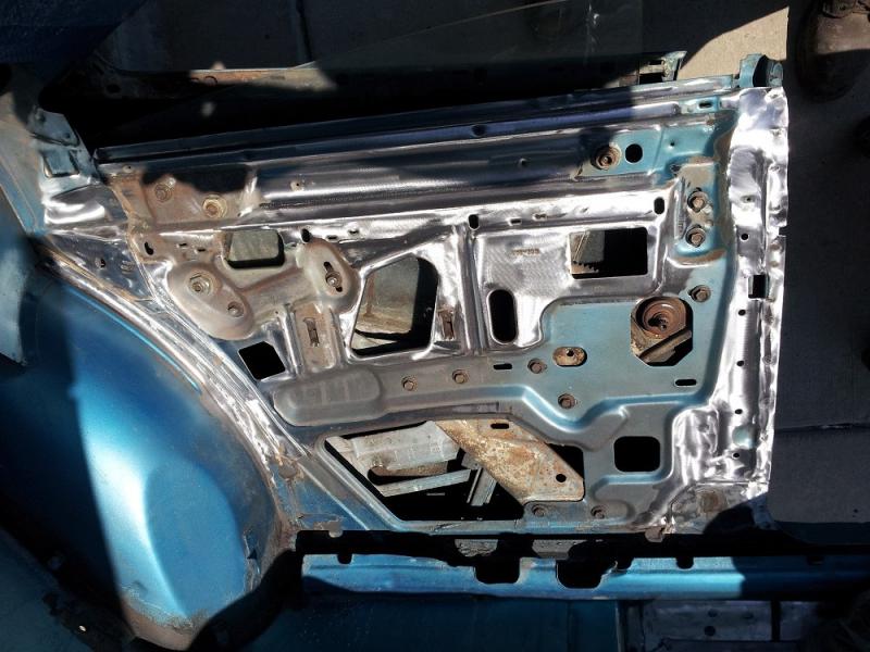

Thank's for the quick response and the great pics! I have the same Plymouth Service Manual and I wish the opening in the lower interrior part of the panel were as big as the one in the book! I could fit through there. My opening is much smaller, and yes, it is a 1968 GTX. The mechanism is too wide to come out of the same opening that the glass came out. I wonder if I have to break it down further to get it out? I hope not, because I have to put it together some day!

I just did this on my 69 RoadRunner- they will come out through the top! I removed the glass tops, slides, and everything else in there and the mechanism last. I then put it all together again outside the car so I will remember how it goes together when I reassemble it all. Taking pictures is a big help also.
You pretty much have to disassemble it INSIDE the quarter panel, then remove it. The key is removing the regulator from the glass bracket, by removing the spring clips attaching regulator to glass bracket (circled in pic below). As you disassemble everything, as MoparBill said the glass, glass bracket, run channels, all come out from the top, then you can remove the regulator from the big hole at the bottom.
