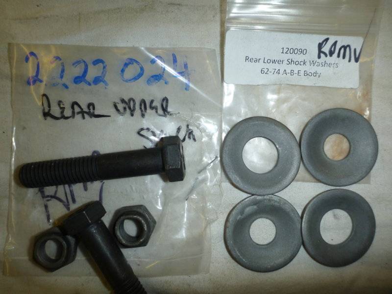

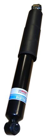

They look like this, the bottom bushings are thick, the top has the metal sleeve extending past rubber, and is narrower than the bottom.

Correct bolts and shank length so they tighten up before bottoming the threads? No reason the shock bulkhead shouldn't pull in tight to the shock head if the smooth shank section is the correct length.

I have a feeling the bolts are not like the original style and bottom out....Also the rear shocks have the same size ends and his do not per his post.....
Thanks guys, I bought the bolts and the lower washers! See if it is the cure for my issue!
How thick are the washers you are trying to use? Maybe try some thinner washers or just one washer and not two. I would also use a local nut and bolt supplier or hardware store for the washers, will be way cheaper and can measure the thickness for you if you don't have any vernier calipers.

Might also be the shock manufacturer trying to cover more applications with a shock that is a tad thin
on the spec, too.
Well the upper shock bolts were shorter with more thread depth, and I got a pair of shocks the had more rubber bushings on the top mount. Super easy fit and install! Got the Springs and shocks in, now just getting the new tank in. Thanks to all that responded!
