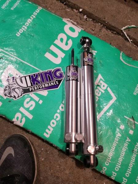

Ordered some Viking shocks from PST. FBBO members get 10% discount they are definitely worth the money.
