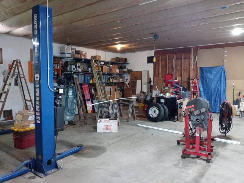

I'll try to remember to measure where mine is at tomorrow. I can get my F150 supercrew w/6.5' box box on mine and JUST inside the door with a good balance to it. Based on my base plate and the floor cut I'm guessing 12 from door, but I'll measure..

I wish I didn't go overboard on the rebar in the hole before I poured. Nail-biter when it was time to drill the post anchor bolts.

I'm prolly 14-15 ft from my door and I've got clearance to walk around on trucks. Cars I have lots of room

My truck is only about 4" inside the door I can tell you that, I'll get the hoist distance later..

I'm 168" from the door. Plenty of room for my Cummins, with room to walk around. I just moved it closer to door, to free up rear space...
Mine's 11' 4" from the door to center line of the lift..so add how ever many feet of clearance you want to that #.
14’ feet. thank you. How much space you think you had to walk around?
Enough to walk around it, with the door closed. It gets cold up here sometimes, so open doors not an option...
