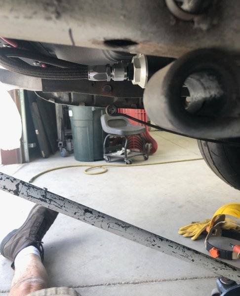

Hey there guys, I'm in the process of converting to a rear leaf spring slider set up. I removed the springs from the rear shackles an have noticed at least a 1" difference in rear spring heights. See pictures

Depends on what car and what springs you have. Give us more info on your combination.
Looks like Calvert springs. If you have the bars, try loosening them off.
Cal Trac split mono springs and Cal Trac bars with Dana 60
Cal Tracs are loosened
Maybe the perches aren't square.
I know mine aren't.
I know mine aren't.
I'm looking at the spring perches on the rear end housing and have roughly a 1.5 ° difference between the 2 rear end perches
