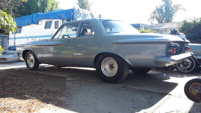

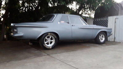

The pics are so you can see my height, 10.5x28x15 on the centerlines, 10x28x16 on the tt2s. The tens fit much better.
