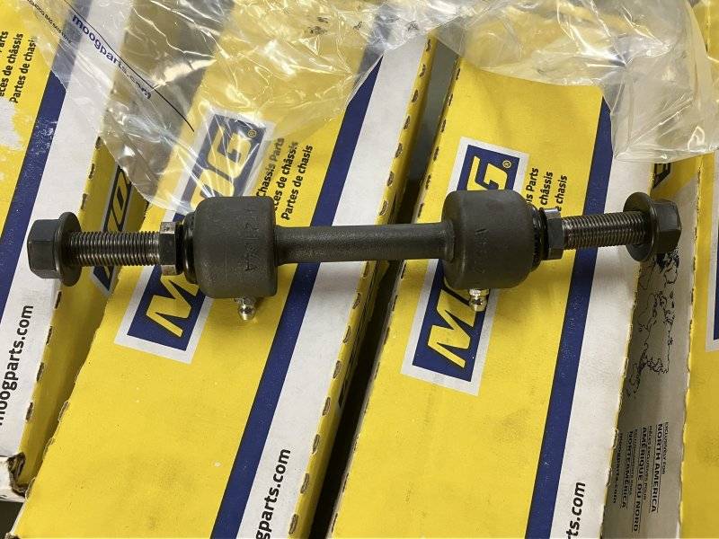

1.25" hollow front sway bar. Moog ball joint style end links.

Where'd you get the ball joint style end links? I've never heard of those.
I may go with PST's 3/4" rear bar, if their bushings for it are polygraphite. The less chance of squeek the more better.

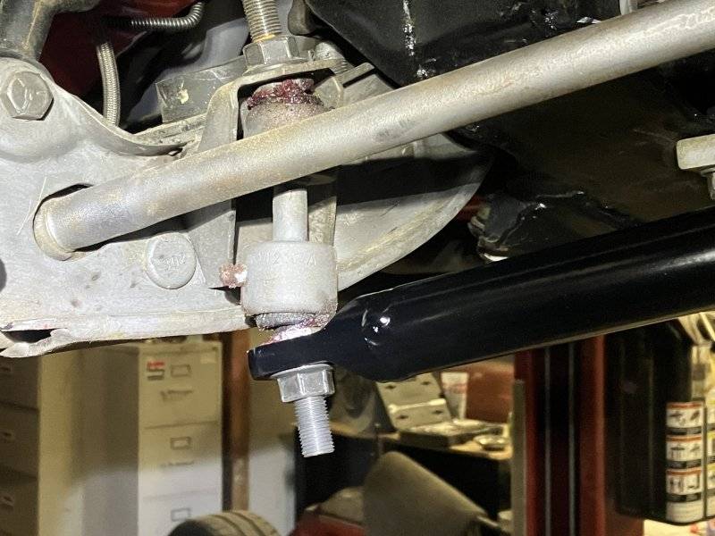

I read about them in Mopar Action magazine. I got mine through Rock Auto. I covered the modifications that I did to make them work in this thread:
Re-Rebuilding the 440-493 in a 1970 Charger
The sway bar end link portion begins at post # 226.
I had to shorten mine to allow for proper fitment. I cut, welded, sandblasted and then........

These links swivel on ball joints. No bushings to squeak or flex.

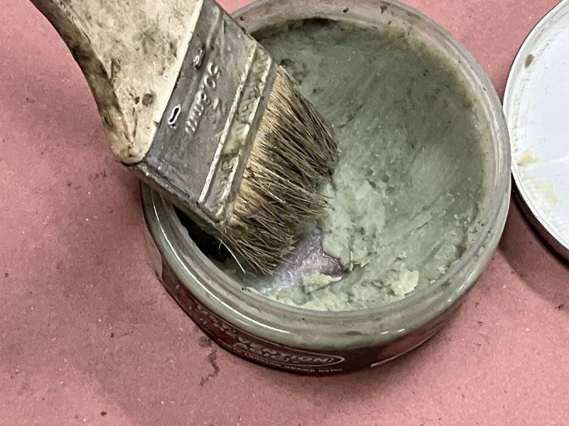

Does the RPM dry?
The RPM is a semi dry paste. I heat up the part and brush the RPM onto it. The RPM can then be rubbed into the metal by hand or with a towel. It keeps the unpainted metal parts looking new.

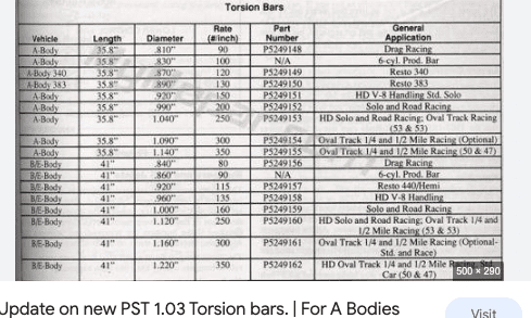

On my '72 Satellite Sebring Plus 318, I currently have no sway bars. I have purchased a factory rear bar and I have installed PST 1.03" torsion bars (listed on website as 41" and 210 lbs/inch). Looks like I better be careful after the rear bar is installed. But wait a minute, I don't even know if the factory rear sway bar will fit a vehicle with a 8 1/4" differential???
Is there a source anywhere to find out what all the different Mopar torsion bar spring rates are?
