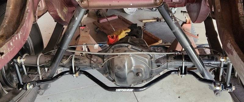

KD explained it very well with the balance of front and rear. With your current setup I think adding a rear sway bar would work great. If you opt for a rear bar from Firm Feel, it mounts frame hung like factory up over the rear axle - meaning you can't see it hanging down below the car.
As Kern said, it's all about balance... If the rear is to stiff the back of the car will want to pass the front of the car.. AKA Tail Happy.... If the rear is under sprung at some point the front tires are gonna push, You turn the wheel, the front wheels turn, but the car doesn't.... Stock these cars under steer, a bigger front bar means more under steer... Adding a rear bar would probably be a good thing... One suggestion, some rear bars have multiple mounting holes, this allows you to tune/tailor the effect of the bar... Like shown below.. Shorter lever = more oversteer, Longer lever = more understeer..

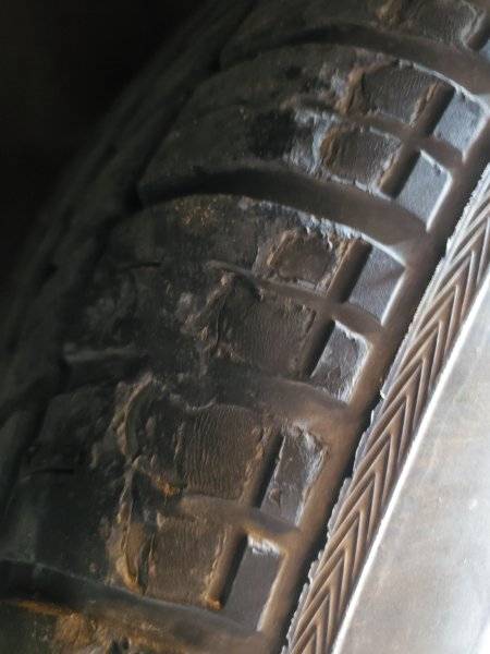

I have a 1-1/8 front bar and 7/8 rear and stock bars and springs. Depending how I drive in corners it balances well. Under hard brake it pushes. Under neutral throttle it's very balanced or maybe just a tiny bit loose. On acceleration it really depends how much tire spin I'm getting. Overall though I feel after my last autocross I feel like I found the traction limit of my tires as I am wearing off the shoulder of all 4 tires.

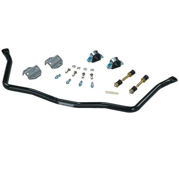

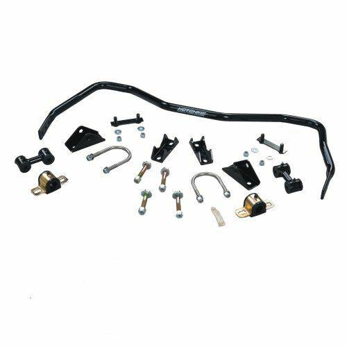

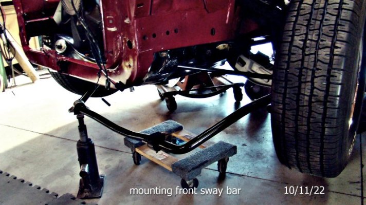

i am about to install and Hochkiss front and back... hope this isn't to much for my car.
Should be great! Be sure on the front to install the bar with the bend in the middle facing up like a letter "A" and not down like a letter "V". Ignore the Hotchkiss logo orientation. The bar should fit up and over your rad support-to-K-frame short connector piece. I installed mine upsidedown the first time because I was referencing the Hotchkiss logo.

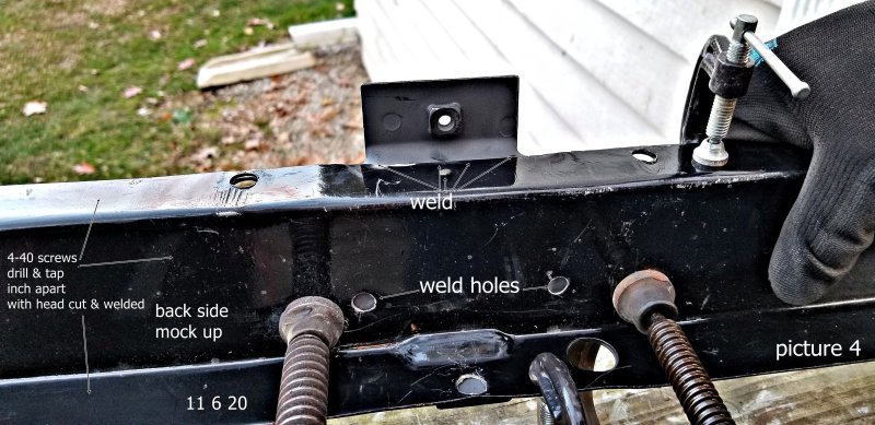

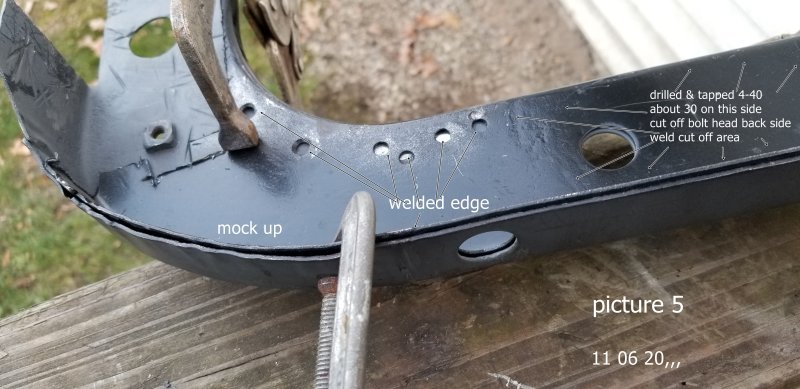

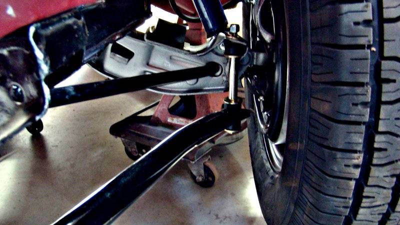

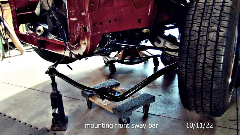

Yes.....the front sway bar is very confusing... they want me to weld in to my K Member which I did not.
my helper and I am still pondering over this.... it is temporary on hold pending a better solution as the photo depicts.
The front sway bar is massive in comparison to the original equipment.
but with the heavy hemi dominating the front end.
I plan on taping the mount with a fine threaded 8 grade bolts and not do any welding to the expensive hemi K member is my temporary plan (subject to change in the next day or two)
My inner fender has bracing for added strength... + I laminated two lower radiator supports or 8 gauge thickness for added strength.+ frame connectors up coming also.

You are correct on the front sway bar. My car is a Sport Satellite and I had a shop weld in the sway bar support brackets to my k-frame. Since yours is a Hemi, I don't blame you. Call Firm Feel or PST and see how their front sway bars mount. Then you could return the Hotchkiss piece uninstalled for a refund. You could also call Hotckiss to ask what your options are.

The think sway bar is quite radical that thick.

the Hotchkiss bar is hollow, which requires the Outer Diameter to be bigger than a solid rod of smaller diameter to achieve the same stiffness. Other manufacturer sway bars are solid. The hollow bar is the way to go in terms of weight savings vs strength if it suits your application. Look at Firm Feel or PST - I think they offer solid front bars that are smaller diameter.
