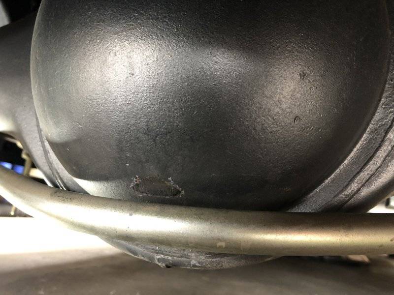

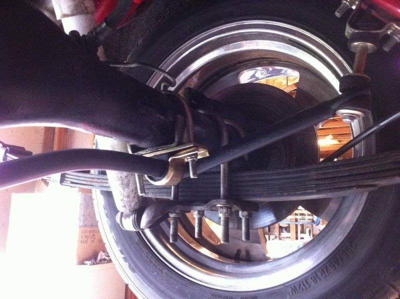

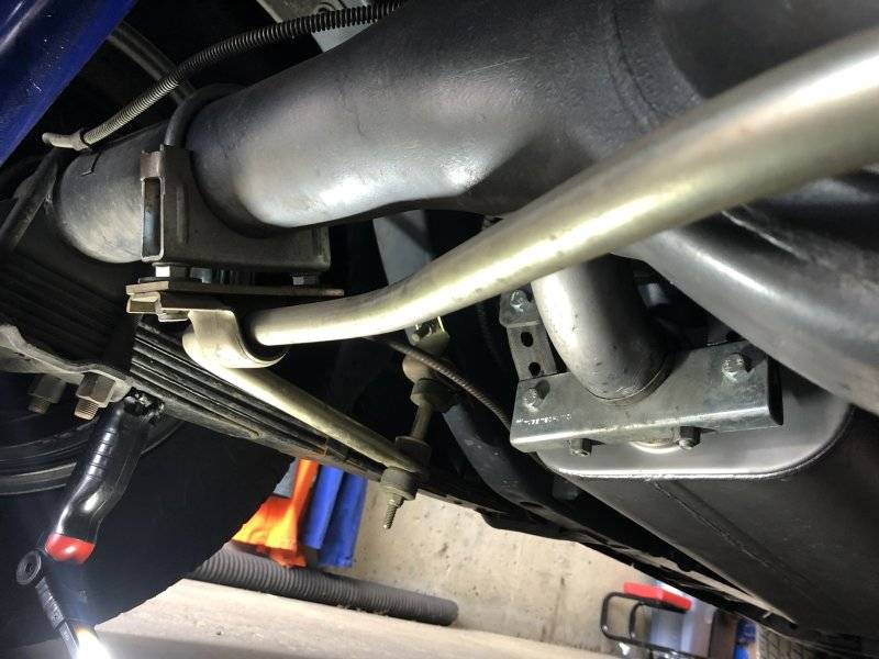

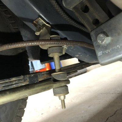

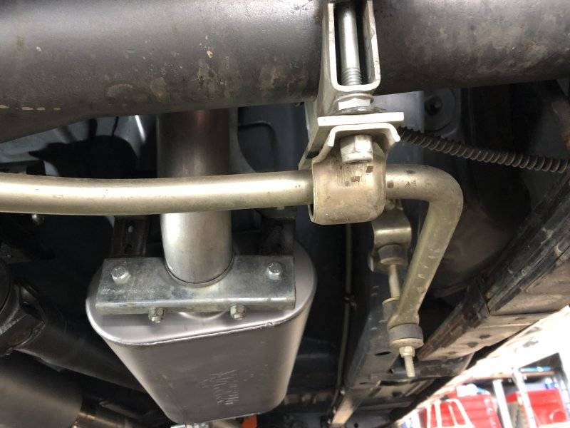

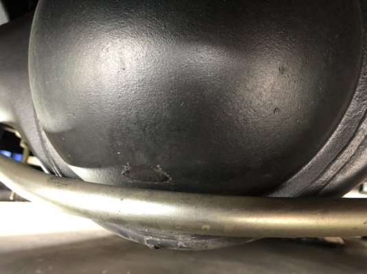

I had an Addco 7/8" rear sway bar in my Charger. The thickness, along with the short end links and weird mounting style had many drawbacks. Suspension travel was limited by it, the U-bolt attachments at the axle housing would move around and the car oversteered easily despite having an 1 1/4" front bar and 1.0" torsion bars.
I think that this 7/8" bar would be a better fit using rubber bushings on the end links, a better attachment method on the arms and at the axle. I switched to a frame hung 5/8" bar from an '83 Imperial. That, along with 1.15" torsion bars and Bilstein shocks made for a neutral handling car that is much more predictable.

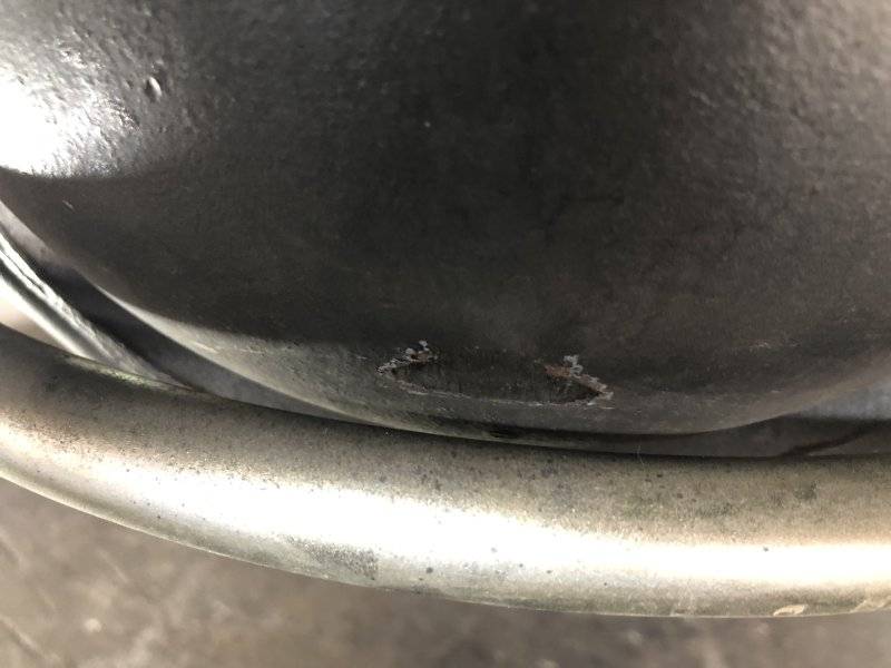

I mean, look at this hokey setup.....The bar was great. Everything else looks like it was designed by some idiot.
