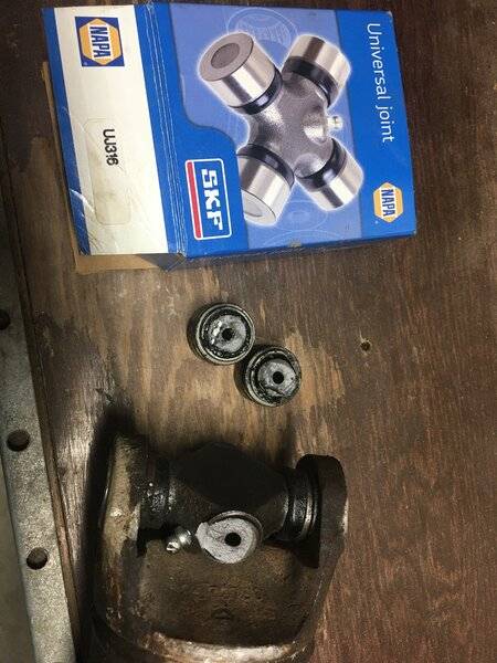

What are all you guys running for a rear universal joint with a 8 3/4 suregrip rear end ? .. I have sheared 2 universal joints on the differential end so far this year. The car is equipped with a 500 stroker running 460 HP and 570 ft/lbs and a 727 auto . I want to get something heavy duty so I dont have to worry about it when I hop on the throttle . I have added pictures of the u joint I was running and the damage , also a pic of the car for ride height

What u-joint are you running 7290 or 7260? Are you running a Spicer joint.

Have you altered the ride height or rear suspension? Tells us more about this car. Seems like you have a Pinion angle problem to have this happen twice.

Is your U-joint the LW chrome Moly? Guy complained on Summit his was made by nepco, a LW vendor. Don't anything about Nepco can't good or bad.

U-joints with the grease zerks are usually weaker than solid ones. Solid means more steel in the unit itself.
When using a u-joint with a grease zerk, the joint should be installed so the drilled hole is under compression
do you have a pinion snubber on the car? The rear axle may be torqueing/twisting up to much under acceleration and breaking the ujoint that way. I have had a couple of 500 inch motors in HP street cars and have never broken a joint...just be sure you have the bigger of the two u-joints mopar used, and get one with out grease fittings.

yes i have a pinion snubber on the car , i went ahead and replaced the u joint today with a spicer 7290
