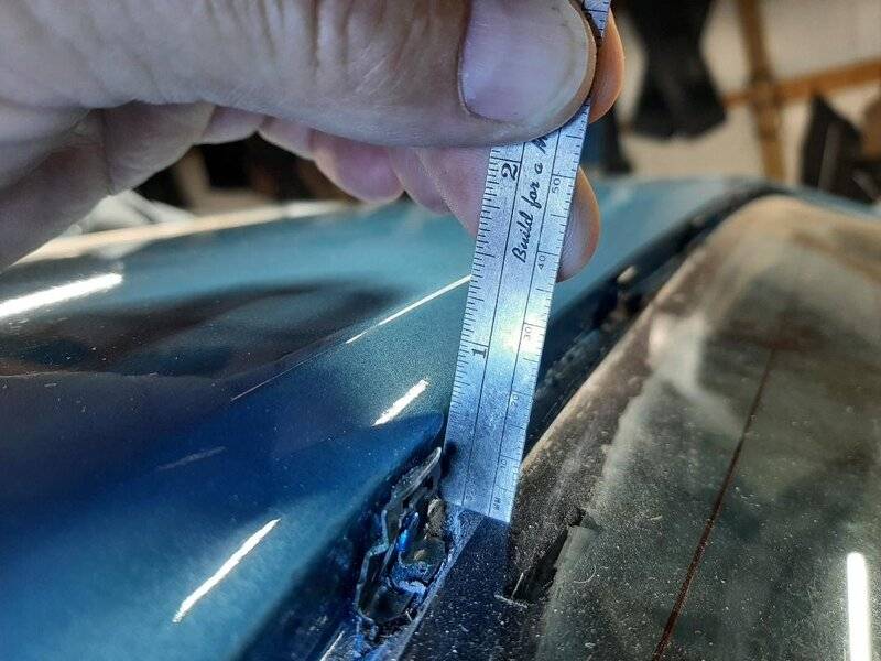

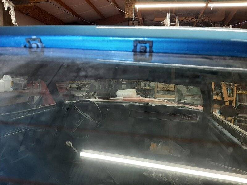

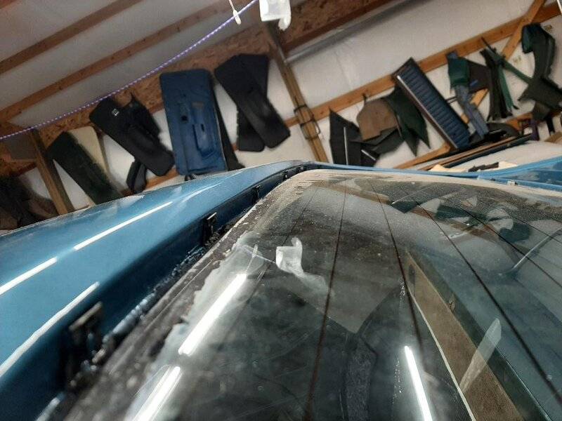

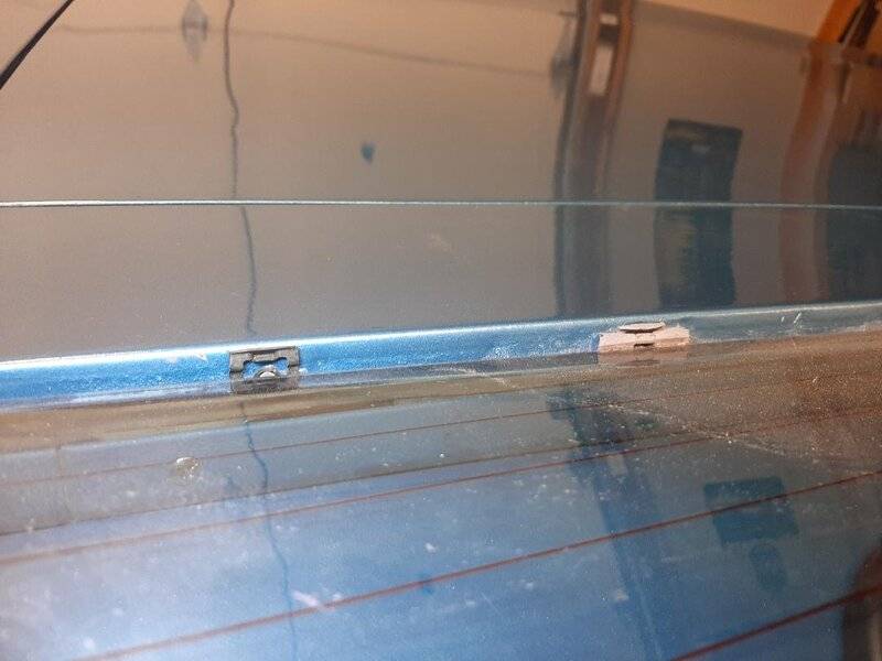

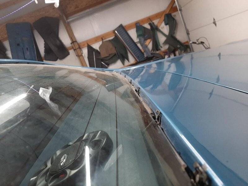

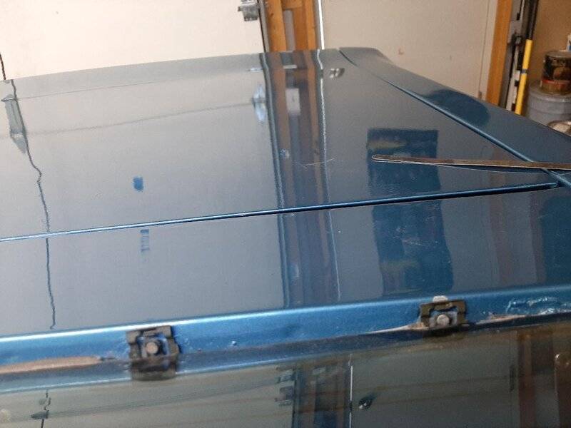

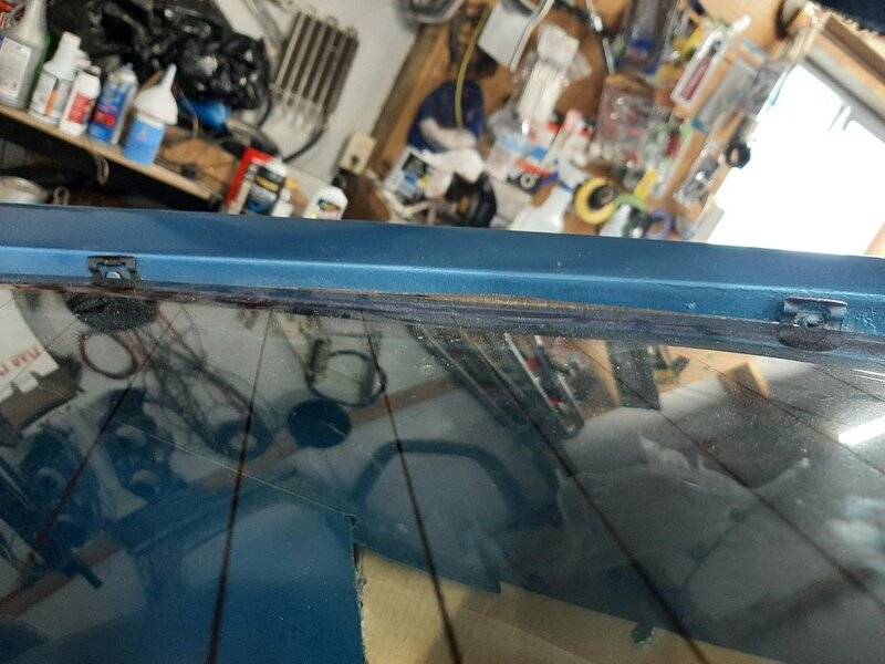

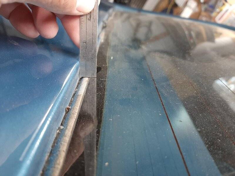

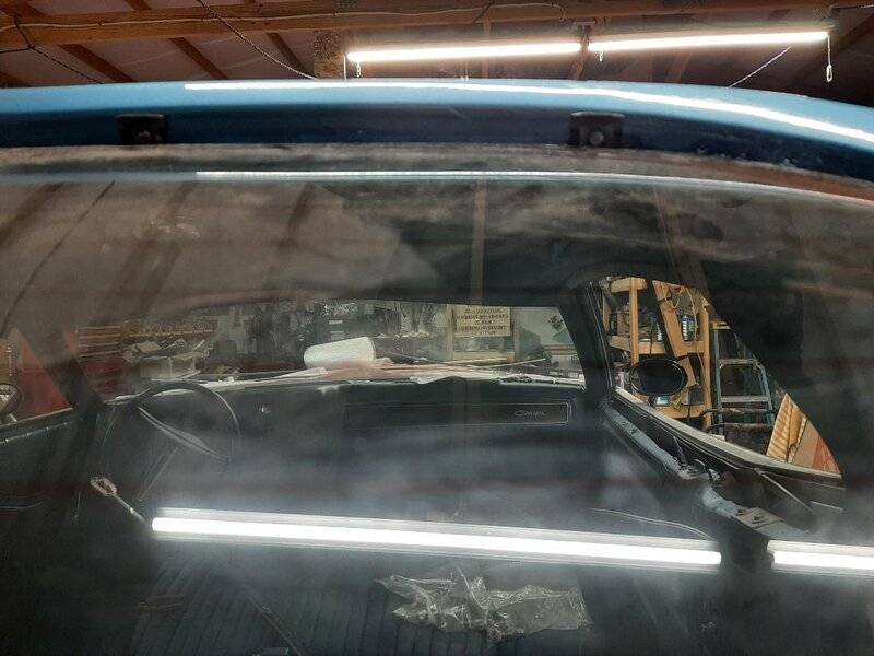

So here's what I found out with the measurements. At the bottom corners of the glass, the window to the edge of dutchman panel was 3/8" on passengers side and 7/16" on drivers side. In the middle on the sides, it was 5/16" on passengers side and 3/8" on drivers side. Across the top, it was 1/2" to 7/16" from glass to roof edge. At middle bottom, it was 3/8" from glass to dutchman panel edge. I did notice the pins the clips slide on to were entirely visible looking across the surface of the glass to the pin's head at the top. At the bottom, about half of the pin's head was visible. On the passengers side, the glass was even with the top of the pin. On the drivers side, about half of the pin's head was visible. So there is some varying of the glass height. Ill add some photos. First is Top Center. 2nd is bottom center. 3rd is bottom passenger corner.

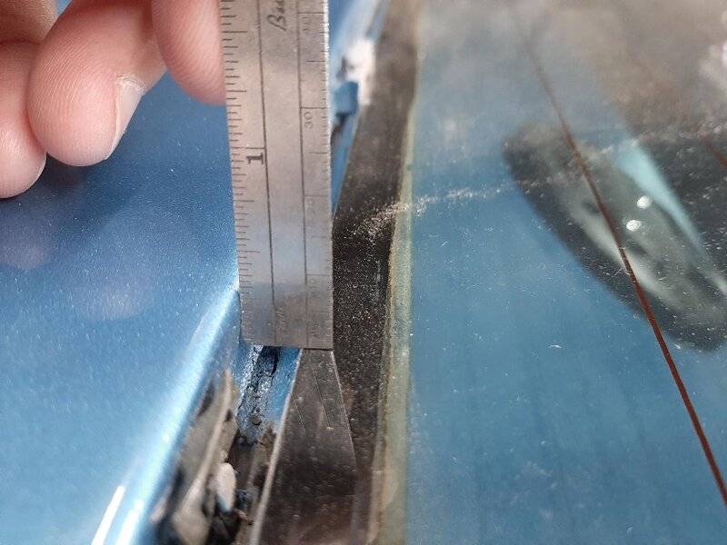

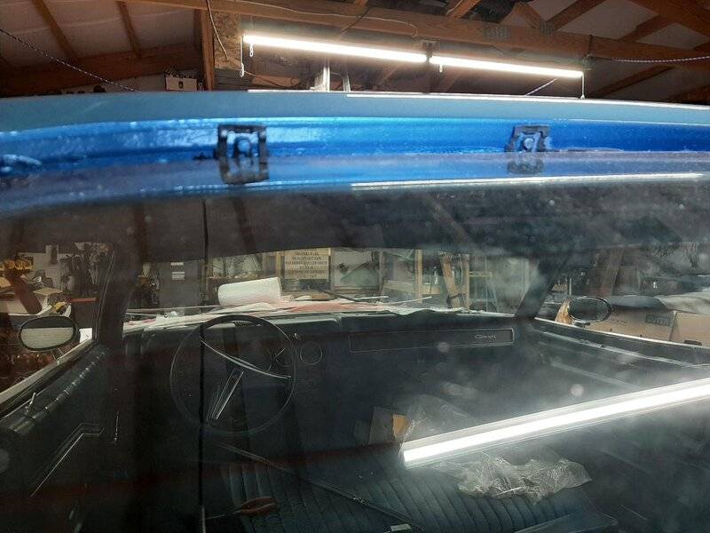

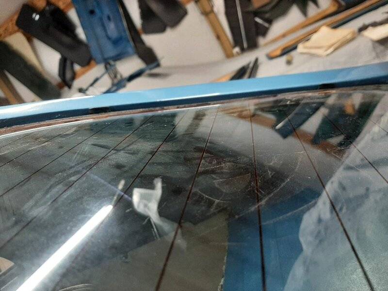

Some more.1st is driver middle. 2nd is passenger side bottom. 3rd is top middle. 4th is top driver side. Last is driver bottom. I hope these help.
Terry W.
Rear Glass 5.jpg Rear Glass 6.jpg Rear Glass 7.jpg Rear Glass 8.jpg Rear Glass 12.jpg
