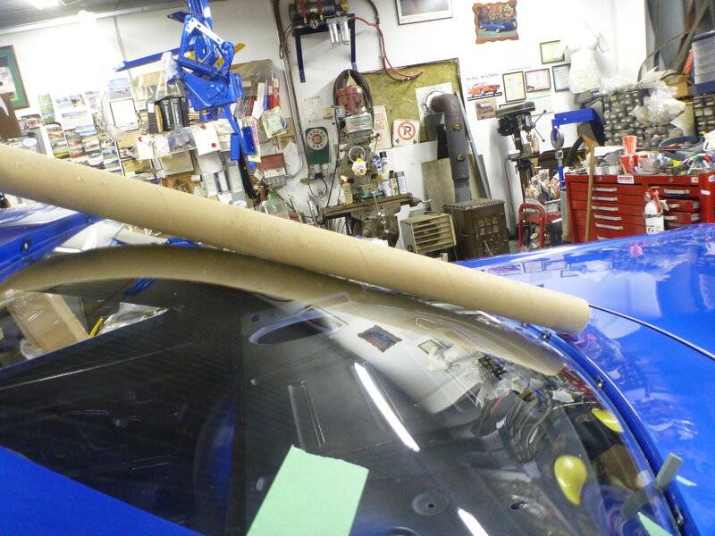

Well here it is. Did not know if I had posted any thing before on the subject. The car is all done but putting the glass in. For the rear window bought one from AMD and put it in and two hours latter it shattered. It was tight in the bottom corners. But not that bad. Trim and all was on and was cleaning up when I heard a pow sound and yep it had shattered. So have ordered another one from Metro part's tried to put it in to day and it wont even fit in at the bottom. Don't look like the original with the curves. So now looking for an used good back window. I did use the old one to test fit as I was rebuilding the car body. It fit's in and just cant get a new glass that is the same measurement's for some reason. Any Ideas would be a grate help. I am not going to start ripping things apart to make a window fit this would destroy all the work I have done to the car. Down to the finish now. Thanks blue69runner.

The curvature Of non OEM may be different as others can attest.

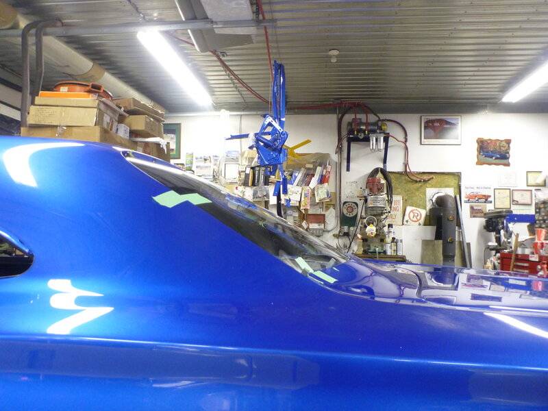

Just to say guy's that I measured every thing when rebuilding the car. Did have some problem's with the quarter. Not enough curve in the window channel to get the quarter to swing over the inner structure. Had to bend it out and get so it would go over the structure. But the back glass fit even after filler and all. It is a mystery to me. Oh well will keep at it till I find an answer. LOL.

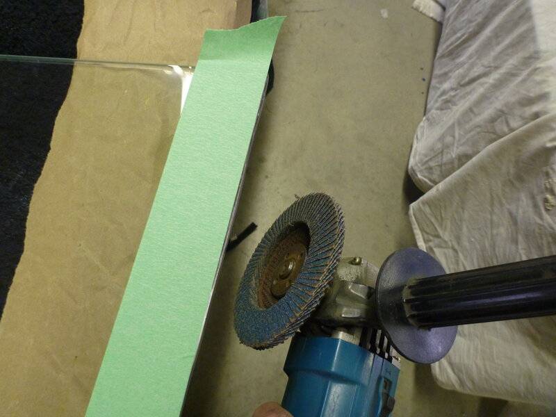

You'll be glad that incorrectly shaped AMD POS is in the trash can! I've been down that painful road. Looks like a windshield, not a back glass with correct triple curves. Thankfully I got my 600 canuck bucks back and returned mine and installed an OE that I spent numerous hours polishing. Find a good OE glass and if need be you can grind some edge off to make if it fit nice. DOWN the glass edge, not across...
Thanks dadsbee. That is what I have in my mind for sure. Every one say you can cut tempered glass but using sanding disc and water to keep it cool you can shave it down. So wish me luck I really need this to happen. It is holding up the build for sure. Blue.
