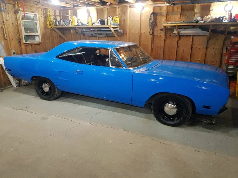

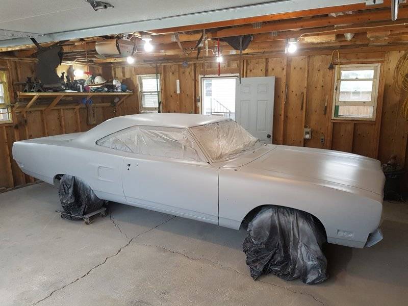

The work was all done by myself and my friend in my garage, except for the paint and exhaust. We didnt know enough to fit the trim when we fit the new quarters. Live and learn. Overall, the car is coming together nicely, other than a few little hiccups. A few pics below. I'll see what we come up with for a solution.
View attachment 823923 View attachment 823926
WE all have made similar mistakes....One thing is for sure the car loos wonderful....
